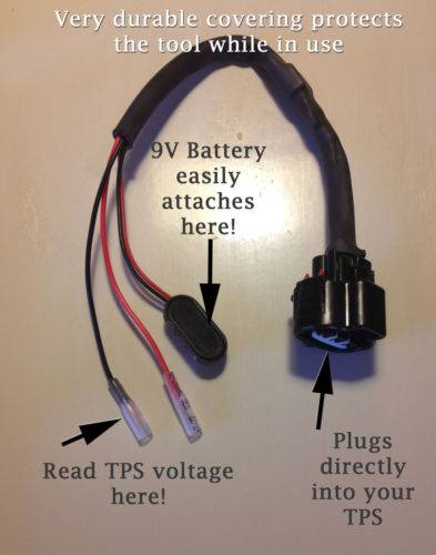

In summary: I'm making a throttle position sensor test tool. manual is asking for 5.0v +,- 0.01i plug power into wall, plug in TPS, use meter to probe common negative to supply 5.0v to confirm start setting then probe TPS out to negative and set TPS to 4.0 or 4.20.thank you in advance for any help
Mikel_NY
41
hey All,
i have an old wall charger that is 120v AC input, 5V DC output @1 amp. when i put meter on output i get 5.19v dc. i need 5.00v dc.
How can i get to 5.00v?

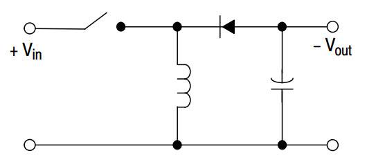

A simple Voltage Inverter can make 5.0 V DC no matter whether the input voltage is more or less:

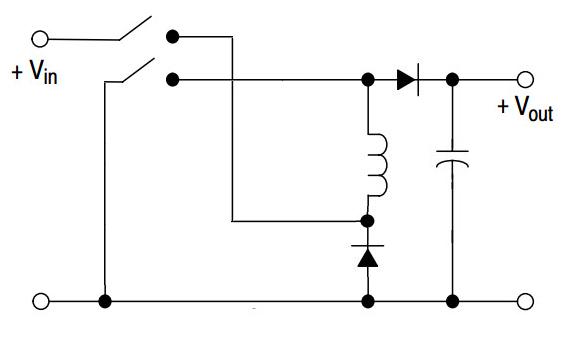

If that accuracy is really needed, then you don't wanna' do this with direct DC-DC, nor you wanna' mess up the grounding just like that...
As for the ground, we can modify it like this (the switches are simultaneous),
― physically, it's a simple "buck" regulator with an n-channel MOSFET and a diode added.
the tps does not use any current ... if i read the wall plug directly its 5.19v dc. i have read this for a few days w/ no variation. once i plug in the tps, the wall wart is still 5.19v. then i move pos prob to tps out just to read its value.
i don't know the difference of a supply vs a reference voltage like some keep referring to. I'm a rookie in electronics but learn quickly the basic stuff. i made a black box in this video ... i want to change the 9v battery out and add wall plug. i will dig up schamdic for the black box as i threw mine out (frustrated w/ batt)
the pic is a newer style of the black box. i would guess the lump in the upper right is a 5v regulator.

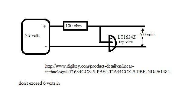

I don't believe your TPS draws zero current.
Every one i encountered was an adjustable resistor (potentiometer) of a few thousand ohms. So i think it'll draw a goodly chunk of a milliamp.
This gizmo is called a "shunt reference" , it absorbs current trying to maintain 5.000 volts cross itself. Sort of a super accurate zener diode. You buy whatever accuracy you want, from about +/- 2 to 20 millivolts.
Datasheet here, http://cds.linear.com/docs/en/datasheet/1634ff.pdf
just one of many places to buy them
http://www.digikey.com/product-detail/en/linear-technology/LT1634CCZ-5-PBF/LT1634CCZ-5-PBF-ND/961484
It should work so long as your TPS draws less than about 1.8 milliamps.
Use it only with that 5.2 volt supply you have. It'll burn itself up trying to hold down a 9 or 12 volt supply.
