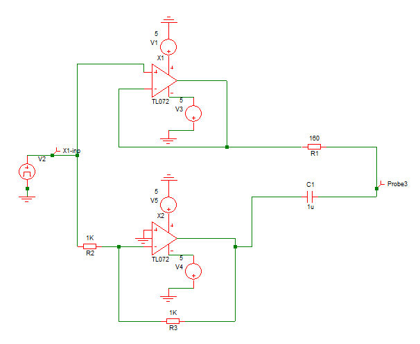

I need help analyzing this phase shifting ckt.
Basically, its a sine wave fed to one end of a Resistor and an inverted sine wave (180 deg) fed to one end of a capacitor.
The other 2 ends of capacitor and resistor are tied together.
As you vary the resistance of the resistor, the phase of the resulting output at the intersection of R & C shifts with respect to the input.
I don't understand how this ckt works. I have no clue how to start analyzing this.
I thought the voltage at R and the capacitor voltage (which lags by 90 deg) add together.
But after simulating I found that's not the case.
In the attached ckt, the 2 opamps feed the sine wave to R and C.

If you connect the sinewave to the left side of the open circuited resistor at the bottom LHS, (just a typo), the opamp circuits do no more than generate a sinewave across the RC network.
The voltages across the components do add, but they add vectorially.
In the following diagram, the voltage from the opamps is shown as V total and the voltages across the resistor and capacitor are shown as sides of a triangle.
[PLAIN]http://dl.dropbox.com/u/4222062/R%20C%20vector.PNG
Start with the bottom triangle.
The voltage applied to the series RC network is V total, and the current is in phase with the voltage across the resistor. So, the current leads the applied voltage by angle X. (Rotation is anticlockwise).
If you now rotate the applied voltage (v total) by 90 degrees anticlockwise, then the other vectors will also rotate by 90 degrees, but keep the same relationship to each other.
As you might expect from your knowledge of right angled triangles,
V total 2= V resistor 2 + V capacitor 2
The frequency affects the reactance of the capacitor and this affects the total current and the phase relationship between the voltages across the capacitor and resistor and the applied voltage.

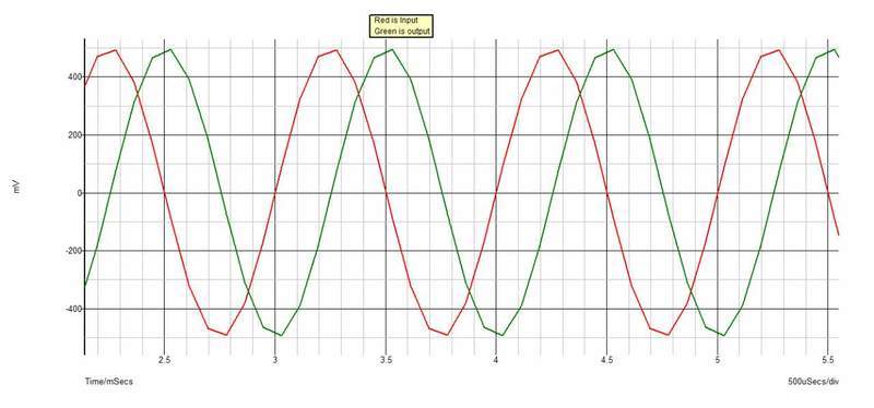

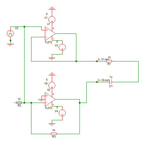

I read your explanation and tried to apply it to a particular case. But things are not adding up.
Let's say, the frequency is 1KHz sine wave, 1Vp-p amplitude.
Xc is 160 ohms.
So I made R also 160 ohms.
Now, I expect both Vr and Vc to be equal in magnitude.
Vr will have a phase angle of 0 degrees.
Vc will be -180-90 = -270 degrees.
So the resulting Vout will be sqrt (Vr^2+Vc^2)
Phase will be -315 deg.
When I simulated, I get a phase lag of 90 degrees.
See attachments.

If V total is 1 volt and the resistor and capacitive reactance are equal then the triangle will have angles of 45 deg, 45 deg and 90 deg.
So, work out the two voltages across the capacitor and the resistor.
1 2 = Vr 2 + Vc 2
so Vr = 0.707 volts and Vc = 0.707 volts.
The current leads the supply voltage by 45 degrees.

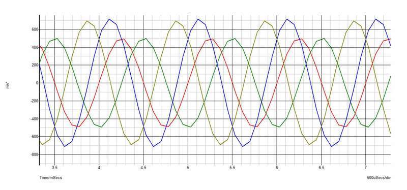

By V total do you mean the output at the intersection of R & C?
What exactly is Vr. Is it the voltage across R?
I put a differential probe across R and C.
Vr and Vc were 1.4V.
Vt = sqrt(1.4^2+1.4^2) = 1.96
But output voltage is 1V in the simulation.
I don't see any voltage that's 0.707

I measured the voltage across the op amp outputs. It's 2Vp-p
Voltage across R & C is also 2Vp-p
The output shifts from 0 to 180 with constant amplitude (which is same as input).

Where you have a node like that, driven from multiple voltage sources (Vi) each through its respective admittance (Yi), you can find the node voltage as a linear combination of the driving voltages. That is,
[tex]V = \frac{\sum Y_i \, V_i}{\sum Y_i}[/tex].
In this case,
[tex]V_o = \frac{(1/R) V_1 + jwc (-V_1)}{1/R + jwc}[/tex]
[tex]V_o = \frac{1 - jw \tau}{1 + jw \tau} V_i[/tex]
[tex]H(s) = \frac{1-\tau s}{1 + \tau s}[/tex]
This is the classical TF of a phase shift network. It is easy to show that,
[tex]|H(jw)| = 1[/tex]
and
[tex]\arg(H(jw)) = -2 \, \tan^{-1}(w \tau)[/tex]
So the output amplitude is independent of frequency and the output phase varies continuously from 0 degrees to -180 degrees as [itex]\omega[/itex] varies from DC to infinity.

I1 = (V1-V)/R
I2 = -(V2-V)/Xc
I tried to plug this to the I1+I2 equation, but got nowhere. I am not sure if my I2 equation is correct.
That should work, but you've got the sign wrong on I2. Since we are summing currents to zero then we must have either both currents into the node or both currents out.
Use,
I1 = (V1-V)/R : directed into the node
I2 = (V2-V)/Xc : directed into the node
How do you account for the 180 deg phase shift in V2.
It inverts the signal That's the same thing as a 180 degree phase shift for some signals, but fundamentally it just negates the signal.
V2 = -V1
Also, why can't we solve this by finding total current I and then the voltage across capacitor C?
You can. I've checked that method and it produces exactly the same solution as before. Remember however that you don't just want to solve for the voltage across the capacitor. The output voltage is V2 plus the voltage across the cap.
Solve for "I" then use,
Vc = Xc I
Vo = V2 + Vc
Vo = Vc - V1
This also gives the correct answer.
Edit the above (just realized that you where using reactance instead of impedance in your equation). You have to use impedance as phase is definitely important when summing currents at a node.
Use,
I2 = (V2-V)/Zc : directed into the node
Use,
Isn't Zc same as Xc for a capacitor?
I tried to solve for V using I1+I2=0
(V1-V)/R + (V2-V)/Xc = 0
V2=-V1
(V1-V)/R - (V1+V)/Xc = 0
V1/R-V1/Xc = V/R +V/Xc
V1(1/R-1/Xc) = V(1/R+1/Xc)
V1(Xc-R) = V (R+Xc)
V = V1(Xc-R)/(R+Xc)
ah! got it.
I don't think this would work for R & L.
What if V2 is 90 deg out of phase with V1.
V2= -jV1?
No, technically the reactance "X" doesn't include the "j".
Xc = - 1 / (w C)
Zc = - j / (w C)
V2=-V1
V1(Xc-R) = V (R+Xc)
V = V1(Xc-R)/(R+Xc)
ah! got it.
Yep just make sure you include the "j" in the Xc and that's it. :)
