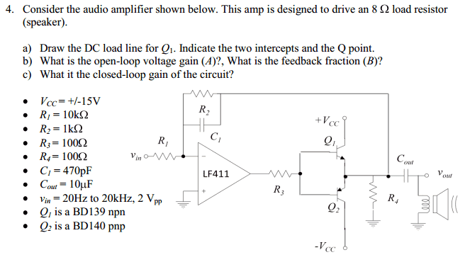

I am confused where to start this problem. Obviously i need to get at the DC load line for Q1. But the problem is that I was taught in class that the DC load lines intercepts for a transistor are x-intercept Vcc and y-intercept Vcc/(Re+Rc). But Q1 has no Re OR Rc! So how am i supposed to find its y-intercept?!
Secondly I don't exactly know what open-loop voltage gain is, what is "open-loop" referring to? The voltage gain without the feedback loop? I am just unsure how to analyze the circuit like this?
Lastly, is by "closed loop gain" do they just mean the overall gain of this exact circuit?
Any help in guiding me through part a, b or c would be greatly appreciated!
Suppose Q1 is ON and near saturation. What will Q2 be doing under those conditions? What is the current path for Q1's Ic? Is there more than one path?
Yes, it's the voltage gain without the feedback path.
Yes.
Looks like you've got the gist of it.

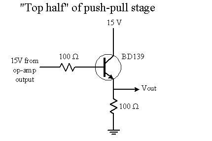

When Q1 is on an near saturation? Well aren't they in push-pull configuration? So whenever Q1 is ever on Q2 is off, i don't know what Q1 being near saturation entails...
Yes, Q1 being on implies Q2 being off. So that eliminates one current path. Being near saturation implies that the transistor is as "on" as it can be. Now it could be that the overall circuit precludes the transistors being driven to saturation, but we're looking at the load line here, which has as its intercepts the extreme possibilities.
If the given transistor (BD139) is saturated, what's its collector-emitter voltage? That should tell you what the maximum possible potential is at the emitter...
the collector emitter drop when Q1 is "as on as possible" is simply Vbe (Which is standard 0.7volts), right?

I think i just realized that the y intercept is at VCC/R4 because R4 is acting as the emitter resistor.
Is R4 the ONLY path for the emitter current?
But why can we assume the transistor is "as on as possible"? Isn't the Q point somewhere in between?
Yes, the operating point lies along the load line (usually somewhere in the middle). But the end points of the load line represent the extreme possibilities of circuit operation. They occur at saturation and cutoff.

Since this is DC analysis don't you cut off the count, so for the y intercept isn't the only place for the DC current to go through R4?
Yes, count will be an "open" to DC. But is there anything else connected to the top of R4?
Ah the feedback!
That looks so complicated though, i have no idea how to approach that because it feeds back into the op amp which then feeds back into the transistor..
What's the DC potential where the feedback resistor terminates?
zero, because of the ideal op amp.
so the current splits between R4 in paraallel with R2 which is in parallel with C1, this is complicated

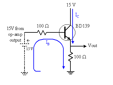

Gotcha! So the voltage is Vcc-Vsat-0.7 and there are two paths, but the current splits between R4 and R2. But we still don't know how much current is going out of the push-pull, right?
VCE(sat) is the only potential drop of interest between the source +Vcc and the emitter (top of R4). It's the collector-emitter voltage.
If you know the potential at the top of R4 / R2 you can find the total current. Q2 is cut off, so no current there...
As you've already stated, R4 and R2 are essentially in parallel and thus comprise your RE...
So current out of the push-pull is equal to [Vcc-Vce(sat)]/[R4||R2] I get it!

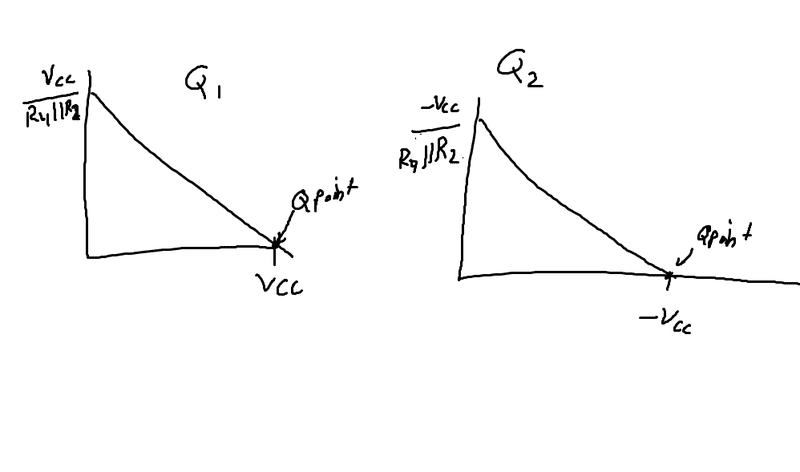

So far, you have been figuring out what happens to Q1 when it is on. Don't forget the output stage also has Q2.
So far, you have been thinking about what happens when the output of the op-amp stage is a positive voltage. Now think about what happens when it is negative.
So is this an accurate image of what the two Load lines look like?
gneill said:
It's not that it's off that is the important thing. It just happens to be off at its operating point. It's where the transistor in this case "idles" when there's no signal applied to the circuit. If you think about it, this makes the circuit very efficient since no current is drawn by the transistors with no signal applied. This is quite different from the case of the common emitter single transistor amplifier where the transistor must be biased to to some point in the middle of the load line so that it can handle both positive and negative swings of the input, and so draws current even when no signal is present.
I guess i never truly understood what the Qpoint was. I always just assumed that it was the collector current and Vce drop that the transistor "wants" to maintain when it is currently turned on.
Yes, the images look okay to me.
The Qpoint is where on load line the transistor "sits" when the circuit is idle (no input signal).
