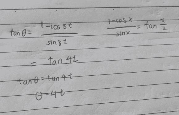

3)
z=sin(8t)+i(1−cos(8t))z=sin(8t)+i(1−cos(8t))
Find arg(z) and mod(z) in terms in t
Since mod(z) is just the root of a square + b square, the answer is as follows.
As for arg(z),
My answer is 4t and √((sin(8t))2+((1−cos(8t)2)((sin(8t))2+((1−cos(8t)2)

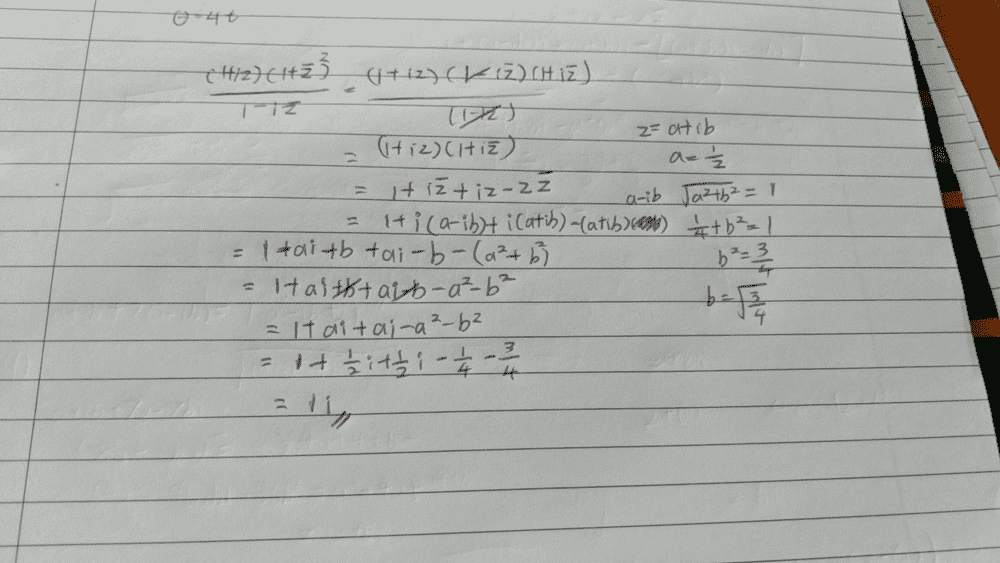

4)
Let z be complex number with Re(z) = 1/2 and mod z = 1
Evaluate (1+iz)(1+¯¯¯z2)1−i¯¯¯z(1+iz)(1+z¯2)1−iz¯
My answer is 1i

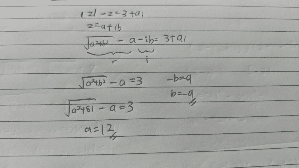

5)
Find value of z such as mod z - z =3+ 9i
My answer is 12-9i

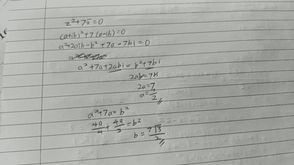

6)
Find z that satisfies z2+7¯¯¯z=0
z2+7z¯=0
My answer is 72+7√32i72+732i

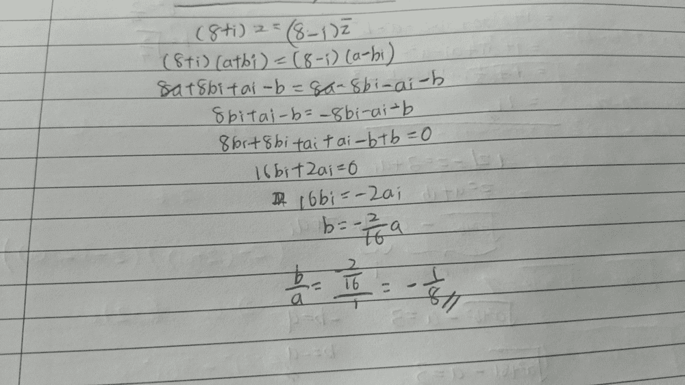

7)
Suppose z is a non-zero complex number satisfying (8+i)z=(8−i)¯¯¯z(8+i)z=(8−i)z¯ Find ratio of Im(z)/Re(z)
My answer is -1/8

for 3 I have my doubts about arg(z)
for 4 I found the expression to be simpy i.
5 seems correct to me.

Updated 4 and 3 with workings :)
Glad we agreed for 4. Easiest way to do it if you know the relations that ##z+\bar{z}=2Re(z)## and ##z\bar{z}=|z|^2## without the need to calculate the imaginary part of z.
For 3 seems you were correct afterall, I completely forgot that trigonometric identity .
7 seems also correct to me.
You should repost the statement and work on 6 cause something is wrong there...

uploaded :)
