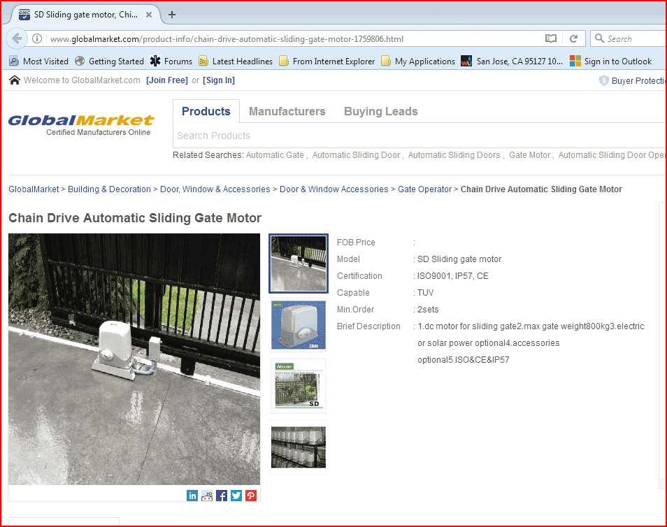

I want to put myself a linear actuator on the sliding gate to the cottage. I looked in the internet, there are a lot of offers and the prices are very different. Maybe there are people here who understand this and can advise me what type of actuator is better, manufacturer and where to buy? I will be very grateful.

Welcome to PF.Are you opening and closing the gate?
How heavy is it?
You could probably use a rotary actuator ratchet than linear.
How far does the gate need to move? I think chain and sprocket systems are used commonly for that...
http://www.globalmarket.com/product-info/chain-drive-automatic-sliding-gate-motor-1759806.html

Those linear actuators have stroke lengths a lot less than 3m. How are you going to lengthen the effective stroke to open that 3m gate?
I thought to attach it not close to the far side of the gate.
Or use something like telescopic tube,
