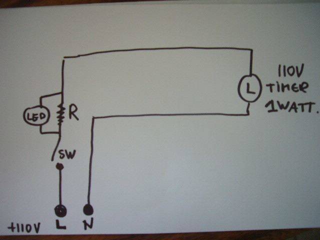

I have a simple circuit switching activating a 110V timer but would like to show an LED ON indicator at the switch SW when the switch is closed, I can do this easely enough if I run the wire from the LED to ground but this means I need a ground nearby, so my questions is it possible to place the LED in PARALLEL with a resistance R so that when the switch is closed the LED lights up !.
I only want to run 2 wires to/from my switch hence the problem. if I put my LED in series with the circuit it doesn't work if I put my LED across the switch it works in reverse IE the LED is on when the switch is open.
This must be a simple problem can anyone help ?
LED is 110V AC

That would only light when the timer has also closed the circuit except that there might be some leakage through the timer when it is not closed causing a feint glow You want another R (R2) in series with the LED. Select the main R to give you about 2.6 volts across it and R2 to put a few milliamps through the LED. The LED will have a about 1.6 V across so R2 needs to drop 1 volt. Putting an (another) LED and series R after the switch and then to N will light when SW is closed whether the timer has operated or not.

Thanks for your quick reply , I'm still confused The LED I have is 110V AC (it does however have a Resistor in series built into it) are you not giving me an answer as if I was using 3V LED or does it not matter can you give me a rough diagram or is that too complicated.
The layout I drew before was purely how I thought it might go but if you a have a better idea please feel free to explain, do you mean that what I have is nearly right but I need to add another R2 in series with the LED and keep R1 (R on my diag) where it is ? what would the values be for R1 and R2 approx so that the 110V LED lights (i think it draws about 0.8mA).
The Timer operates an ondelay to activate a NC contactor to switch off an A/C unit, it all works great its just that sometimes I don't have an Earth to locate onto so that my panel light is on when the contactor is operating.

Maybe it is neon you have? Sounds like it is not suitable. You need an LED which develops 1.6 - 2 volts with a few mA running through it.
R1 is in series the LED and the two are in parallel with R.
As pumblechook implies, this is often done with a neon bulb. You might be better off using a switch with integral neon lamp.

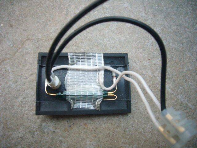

I'm sure it can still be done though, I'm using a reed switch and a magnet but the light must go on (since its a locating light) when the switch is closed ie when the magnet is removed away from the reedswitch

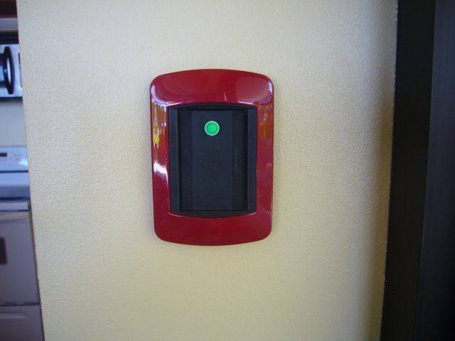

pumblechook please see pics too.
Regards to both for help, now what do I do ?

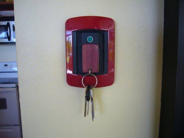

I do want it located physically at the switch as that is the indicator that the system is in GREEN mode hence saving electricity when the timer is started . I understand what you mean when you say that I must connect it as per my diagram but what must be R so that it still sends 110V to the bulb and acts as a contact between the wiper and the load side of the timer, in other words if I just put the neon bulb in place of R it would not work right ? so then what resistance would be sufficient to give me a voltage drop of 110V and yet offer a circuit from wiper to timer on the live side.
I thank you again for your help and hope that you understand what I'm trying to say.

The load is one Watt, you say, so it draws 10 milliamps. I think we can assume that it draws 10 milliamps whether it has timed-out or not. That's enough to light an LED rather dimely.
If I absolutely couldn't obtain neutral and switched-power where I wanted it, I would try two small LEDs in parallel with each other. Put them antiparallel to each other--anodes tied to cathodes. Put the pair between the switch and the load.

Ok got some results using a range of R in Parallel with an LED if I use the LED on its own it lights but doesn't operate the timer I tried several LED together and they helped to start the timer but then failed when the small current the CONTACTOR draws.
So then I decided to use just one LED in Parallel with a range of R from 75k to 1k measuring the current in the circuit and observing the LED brightness and seeing if it operates the timer (30 sec ONDELAY) and contactor in turn
R mA LED TimerOK ConOK
75K 2.2 High Y N
22K 5.5 Med Y Y
10K 8.3 Med Y Y
5.6K 11.5 Low Y Y
1K 16.5 Off Y Y
from the above results it looks like I could get away with using a Resistance in the range 10 to 50K but anything outside that and the light either doesn't come on with low resistance or with high resistance the timer doesn't get enough Juice.

OK I have measured the Current drawn By the timer at 16.5mA and the GREEN NEON light at 1mA, So what safe value Resistor shall I use to have the light on when the timer is on assuming the resistor is placed as per my orginal diagram. (in parallel with the NEON).
I have in practice made a 22K R work and the current draw in the circuit has dropped to 5.5mA when the green light is on and the timer is operating but why has the current dropped ? problem is the higher R the Brighter the LED but the less current is being passed to the Timer to the point where it won't operate at all.
Shall I just stick to 22K is that a safe value that won't overheat ? I want to understand the theory so if one of you guys could explain it to me what is happening ?
Also should this circuit be fused with a ?mA fuse just to be safe as I'm running on 110V on a 2x 20AWG sometimes distances of up to 20M, I know the current draw is small but what worries me is shorts in the even of a wire tear. Can I just put a little fuse near the timer on the Live side ?
Also I feed 220V to my contactor from the timer on similar cable 2x20AWG again its not the current draw I'm worried about (2.5W) its the fact that I haven't stepped down to a safe voltage and I would rather be safe a put a protection in there too. most of the cable is in trunking 7mm x12mm but still you never know !
Any coments ideas ? thanks guys...
