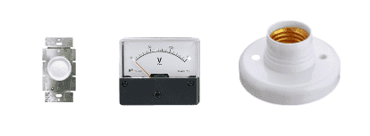

I have a science project lamp that has a dimmer, a volt meter and a socket with a bulb in it. The kids can turn on the bulb, rotate the dimmer and watch the voltage go up and down on the meter. Simple enough.

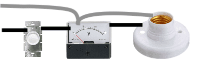

Its like this...
Rotary Lutron dimmer to panel volt meter to bulb.
Could you show some wires, perhaps?
120 volt
hot/neutral to dimmer, hot and neutral to the meter and then to the socket. Thats it.

ILoveDeoxit said:
120 volt
That makes no sense.

Its very simple Averagesuprenova...
Hot wire goes through the dimmer to control the voltage, then it goes to the meter, then it goes to power the light bulb.
Neutral goes to the meter and then the light bulb.
It's not so simple because it contradicts what you wrote in post #12. Your diagram shows the neutral NOT going to the dimmer. The diagram is how I would have expected it, not the way you worded it in the description.
You are correct Averagesupernova. 👍
I messed up royal on post 12. The dimmer only use's the hot wire.
