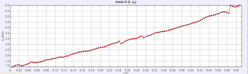

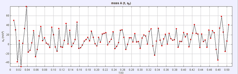

When I look at the free-fall Vy (velocity y-axis) results it is a smooth upward line but Ay (acceleration y-axis) it is erratic and all over the place.
I was wondering if anyone here had experience with the physics program Tracker?
I used it to analyze a free-fall video I made in an effort to learn how the program works. The video is 240fps and 720p. The program reports a smooth upward line for velocity. After the velocity plot is done I double click on it to open the Data Tool. I click the Analyze button and it gives parameter A (the overall acceleration rate) as 10.72 so semi close to gravity.
But if I open the Ay plot for acceleration of the y-axis its a jagged up and down mess with acceleration rates frequently hitting 30m/s2 to -5m/s2
I have not figured out how to smooth out this acceleration. I tried Finite Difference and Bounce Detection
I was originally using accelerometers to measure the acceleration rate as the free-fall objects fell and their acceleration rates were much smoother, consistent, and in hindsight, accurate, but got chewed out by some physicists on reddit that the best method is a video camera and frame analyzation software which is why I am trying Tracker.
I also used hand dropping as my release method but have since converted to an Arduino controlled pair of solenoids that hold a piece of fishing line attached to the back of the free fall object. When I turn off the solenoids with my cellphone over bluetooth it initiates the drop.
Any help with getting the acceleration plot fixed would be appreciated.

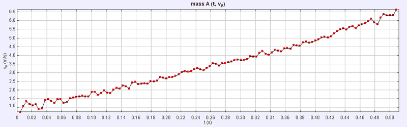

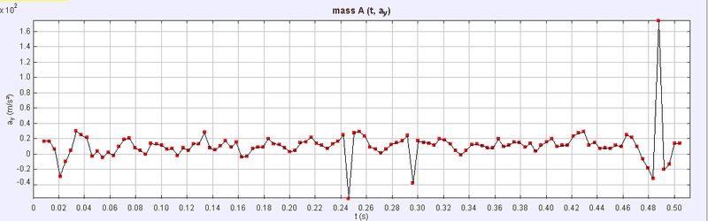

Here are the plots:
Bounce Detection Algorithm Velocity of Y-Axis
Bounce Detection Algorithm Acceleration of Y-axis
Finite Difference Algorithm Velocity of Y-axis
Finite Difference Algorithm Acceleration of Y-axis
Even Bounce Detection Ay oscillates between 20m/s2 and 0m/s2 for much of the duration.
I did use Autotracker. I have so many tests to run I can't possibly tag them all by hand.

From the first graph I see the speed changes from 1 m/s to 6 m/s in about 0.5 s. From this data I compute an average acceleration of 10m/s2. Not too bad at all. Finite differences from experimental data are frequently too noisy.
Use a smoothing process instead of a differencing one. Fit your data to a 2nd order polynomial and read off the acceleration from the fit parameters.
I'll bet that the AutoTracker got confused at the times where the velocity graph had a kink.
It's fair to manually correct the tracking.... Zoom in and drag the tracked-point to where it should be.
