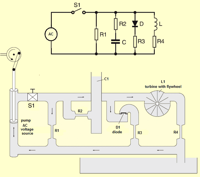

Usually, I don't like the water analogy, but I must admit that it helps sometimes.
Credit this picture to PF member @Jony130 .
It includes resistors, capacitors, inductors, a switch, even a diode. It can work with AC or DC.
Very clever.
