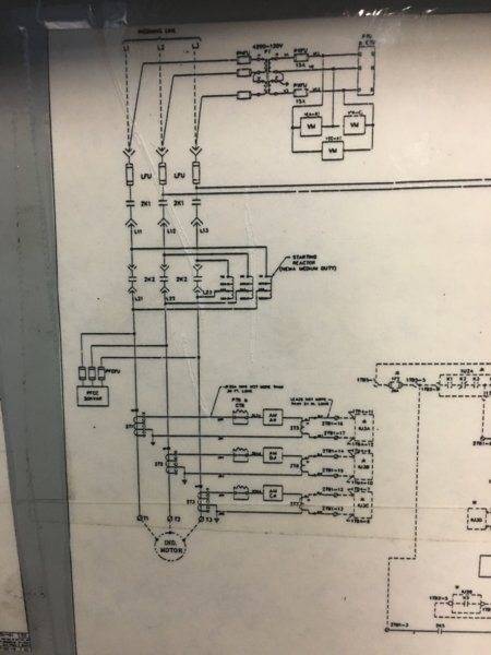

Will someone please help me understand the significance of shorting an auto transformer? This feeds a motor. At reduced voltage, the motor starts at 65% of line voltage, a run contactor pulls in bypassing the transformer and the shorting contactor pulls into take the transformer out of the circuit.
How does this happen? What is the significance of shorting them out? Why is it necessary? And what if they were left open? If anyone can explain in detail I would greatly appreciate it!
Thanks!

During the start period, the voltage is reduced by the Y or star connected 3PH autotransformer.
When running, the common terminal at the centre of the Y is disconnected from all autotransformer phase windings.
The remaining windings are shorted by the run contacts, so the transformer is effectively without voltage or current.
The autotransformer is NOT energised while it is shorted.
If the run contacts were left open, the autotransformer would appear to be inductors in series with the motor.
Series Inductors would reduce the power factor, which is really bad.

A couple of questions:
Are all 3 windings (primary/secondary x3) connect at the common terminal? So as to be consider a single autotransformer and not 3 singles.
And does the shorting process change the configuration to bypass the y connection so to speak?
Right now I have an auto transformer in a primary reactor RV starter. Wired like a PR. Power company installed PFCC and it fixed the problem slightly, but not completely.
I think it’s the set-up but I want to be certain.
One more question— A primary reactor is still left in the circuit, just bypassed by a run contactor. why is that inductance not an issue like it would be with a transformer? (The circuit does have 20uf of capacitance to offset some of the L.
Thanks a lot!
Here’s the circuit. Wired the same only reactor has been replaced with xfmr tapped to 80%.
It seems to be causing some major issues. I just surge tested the “c” phase winding and it appears to be almost dead shorted. I wonder if leaving a medium duty xfmr in the circuit has been causing heat as well.
Thanks again chaps

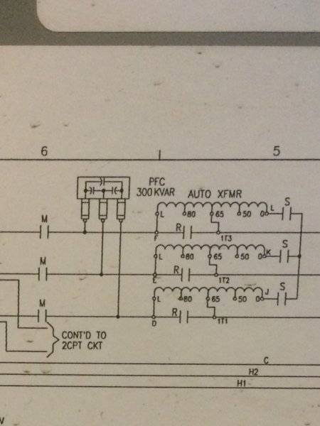

This is a typical auto-xfmr start

The 1st diagram was a primary reactor start setup, which we have, only the reactor has been replaced by an autoxfmr. I can only assume the auto xfmr is now being used as a series inductor and not a xfmr, so line current is not being reduced at start-up and power factor is being affected.
Lower taps should increase inductance, lower stress on motor, but leave line current unchanged. If I understand this right.
This diagram is different than the first. Is this how it is wired?
If so, it looks like the 'M' contactor and 'S' contactor are closed during start. They drop out and the 'R' contactor closes when the start timer completes.
50% tap: 50% current & 25% torque
65% tap: 65% current & 42% torque
80% tap: 80% current & 64% torque
The “autoxfmr diagram” was just to show you how a typical auto xfmr start is wired. How it’s shorted etc.
What I have is an auto xfmr in place of a reactor in the 1st diagram. So it’s not being connected during start up, and is only reducing motor voltage by way of dropping voltage through inductance of xfmr winding.
So it looks like the original reactor start was not a good choice for that motor and caused the voltage dip during start. so someone replaced it with an auto xfmr to try and reduce start up LINE current but did not install a means to connect the windings during start to actually reduce voltage. Instead it ended up operating the exact same way the reactor did.
