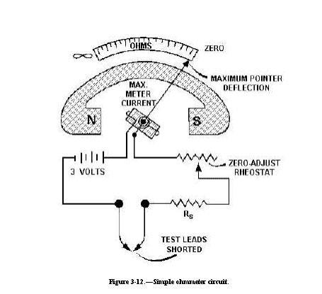

My understanding of this is that the default position of the needle on an analog multimeter is at infinite resistance.
When one lead of a multimeter is attached to a circuit and the other lead of the multimeter goes to ground, I don't fully understand how a multimeter could apply voltage from the multimeter's internal battery to measure conductance through a circuit. When one lead of a multimeter is attached to a circuit and the other lead of the multimeter goes to ground, is it the case that a multimeter measures conductance in a circuit by applying voltage from its internal battery to a circuit and then the multimeter measures the current flow that leaves the multimeter? If not, how does a multimeter measure conductance in a circuit when one lead of a multimeter is attached to the circuit and the other lead of the multimeter goes to ground?

The rheostat adjusts maximum current , which is necessary as the battery ages ..
That one you set with meter leads shorted , zero ohms between them., so needle is over "0" on right end of Ohms scale.
When there's no path for current , which is zero Mhos which is ∞ Ohms,
needle returns to its rest position which should be over "∞" on left end of ohms scale.
You adjust rest position by very slightly rotating the coil spring mount.
That slotted screw head in photo rotates the coil spring mount by a few degrees .
