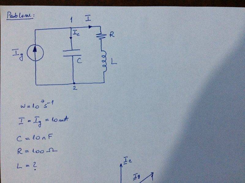

From the given circuit and provided information draw a phasor and calculate the inductance.

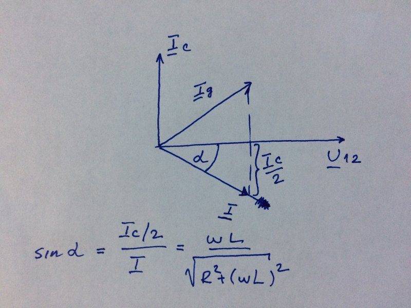

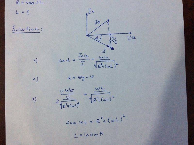

The paper was given to me at class as a solution to our homework and i can't understand how they drew the phasor and drew the conclusion out of it.
I see that they took ##U_{12}## as their phasor axis since its the same for both sides but why do they draw the ##I_c## the way they did? How did they know that it goes up and how did they get the ##I_c/2## part?
The continuation of the left side of the third equation i do get but not the right side. Why is the right side like that?
If the inductor were ideal (with R=0) then IC would lead I by 180°. If the inductance were zero, making it a simple parallel RC arrangement, then IC would lead I by 90°. So with both R and L then IC will lead I by some angle between those 2 extremes. That constrains the shape of triangle that you draw.
You also need to bring into the geometry the condition stated in your data of 2 currents having equal magnitude, viz., I = Ig
NascentOxygen said:
If the inductor were ideal (with R=0) then IC would lead I by 180°. g
Do you mean 90° ?
Numbskull said:
Do you mean 90° ?
No. I is the inductor current. Ic would lead U12 by 90° and if the inductor were ideal, inductor current I would lag behind U12 by 90°. This means Ic would lead I by 180°.
I believe that there is a flaw in the question as posed. Perhaps the angular frequency given is to high? If it is truly ##10^7 rad/sec## then the capacitor reactance is just 10 Ω. The real resistance of 100 Ω in the other branch will make it impossible for it to conduct a current with the same magnitude as the source current, even taking into account resonance effects. If I'm not mistaken the maximum magnitude for the current ##I## would be just 1 mA.
