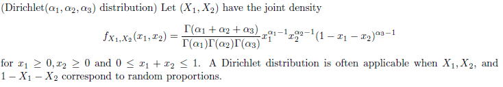

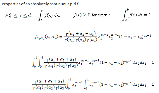

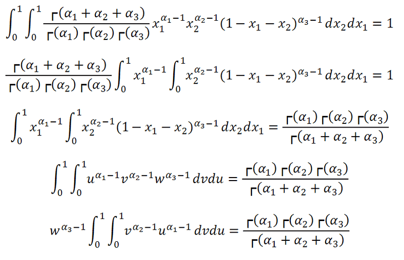

I am stuck on this problem. Can someone give me a hint on how to start?
Prove fX1,X2 is a density.
I think i am supposed to integrate twice to show it equals 1 to show its a density function, but I don't know how to do this...

You might want to look up what properties a probability density function must have. The integral that you refer to in the first post is one of them. You should try to set that integral up. You will probably need to use a change of variables and perhaps the binomial formula to express the integrals in terms of Beta functions.

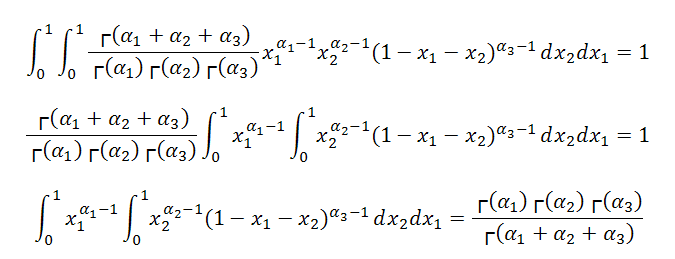

i can get to here
But I don't know how to use the beta function.

It's honestly not a very easy integral to do, but it can be done if you know certain properties of the incomplete beta function. The change of variables I'd use is u = x1+ x2, then the x2 integration will yield an incomplete beta function. You can find a series expansion for the incomplete beta function that will allow you to do the x1 integration in terms of beta functions.

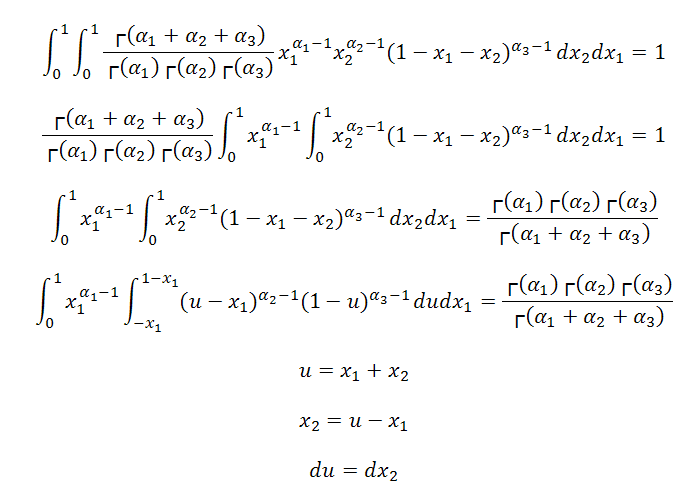

the farthest i have got is
the right side looks like the beta identity, and somehow i need to use change of variables on the left side, the inner integral looks like the beta function, but there is another term inside (x1) that won't let me change it. How can I get rid of the X1?
In any case if you know how to do this, can you help me get started on this...

so now i have
i assume this is the incomplete beta function.
I don't know how to find a series expansion for the incomplete beta function that will allow me to do the x1 integration in terms of beta functions.
i can't figure out know how to integrate the du (inner integral) , How do you integrate it?
If only the -x1 were not there, i can use the identity...
I also may have done the cgange of variables wrong, if i had to use the jacobian, then, it requires 2 new variables, but i only have the u=x1+x2...

There's an indirect way to compute the integral that is based on the way you derive the relationship between the beta function and gamma function. That computation is done on the wikipedia page
http://en.wikipedia.org/wiki/Beta_function#Relationship_between_gamma_function_and_beta_function
In your case you will rewrite [tex]\Gamma(\alpha_1)\Gamma(\alpha_2)\Gamma(\alpha_3)[/tex] using a coordinate change
[tex]u = z x_1, ~ v = z x_2, ~ w = z(1-x_1-x_2).[/tex]
You can then factor the triple integral into the expression for another beta function and a double integral that is the integral you're trying to compute.

Try reproducing that calculation shown on the wikipedia page, the calculation you have to do is almost exactly the same. I can't do the work for you.

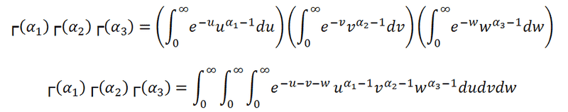

Forget about the identity right now. I told you that you should compute
[tex]\Gamma(\alpha_1)\Gamma(\alpha_2)\Gamma(\alpha_3) = \left( \int_0^\infty e^{-u} u^{\alpha_1-1} du \right)\left(\int_0^\infty e^{-v} v^{\alpha_2-1} dv \right) \left( \int_0^\infty e^{-w} w^{\alpha_3-1} dw \right)[/tex]
using the trick on that page, namely a coordinate change
[tex] u = z x_1, ~ v = z x_2, ~ w = z(1-x_1-x_2).[/tex]
When you do this, you will be able to factor the new expression as a z integral that is a gamma function. The x1,x2 integral will be the integral you are trying to compute.

Yes it's a change of variable on u,v,w with the form mentioned. If you can reproduce the calculation for the beta function, you can do this one.
i now have
do i have to do anything to it before i have do the change of variables?

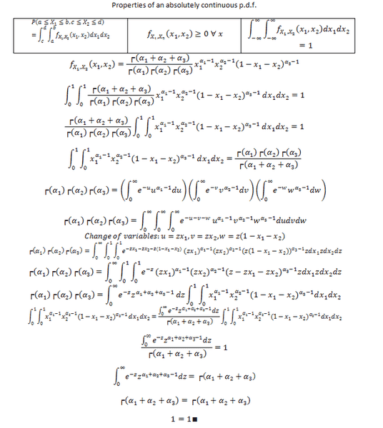

now i have this after the coordinate change
but i think there's something wrong with this
are the ranges of the integrals right?
and in the end isn't it supposed to be dx2dx1dz?
i did something, can you tell me if this is 100% correct, and if something is wrong, can you please tell me
so is the previous post correct??
The calculation is correct, the order in which you're writing things is a bit messed up. Just tossing random formulas around before you've proven them, without writing any words to explain what you're doing isn't a proof. You need to explain that you're trying to show that the pdf is normalized and put the steps down in a logical order.
yeah ok. glad i finally figured this one out...
