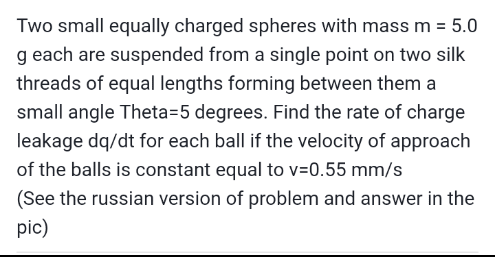

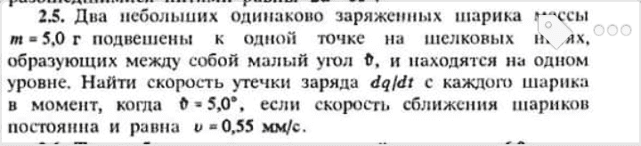

Two small equally charged spheres, each of mass m, are suspended from the same point by silk threads of length 1. The distance between the spheres x << 1. Find the rate dqldt with which the charge leaks off each sphere if their approach velocity v = a/ √x, where a is a constant.
The net acceleration required=dv/dt=-a^2/(2x^2)
This acceleration is given by electrostatic force and weight of the mass.
Is i take components and get the q and differentiate it the answer comes wrong.
Many solutions say that the body is constantly at equilibrium but i don't understand why.

The question means that the system is at equilibrium initially, but as charge gradually leaks away the equilibrium position changes.

But as per the solution we need to take net acceleration every instance 0. Why is it so? Why is it wrong to do that the rate of change of the given velocity is its acceleration and thus the forces along it should be giving it?
Consider a car jacked up. As you wind the jack down, the rate of descent is not controlled by forces on the car - it is controlled by the rate at which you choose to lower it.
It is the same here. The rate at which the spheres come together depends on the rate of leakage. At any instant it is very nearly in equilibrium.

The question could have been better worded. Something like "the spheres hang in equilibrium, but charge gradually leaks from them, allowing them to come gradually closer together at speed ..."
If a small amount Δq of charge leaks at some moment then the system is not in equilibrium and the spheres will start to swing together. If no more charge is lost for a while, and no energy is lost, the spheres will oscillate about a new equilibrium forever. But in the real world energy is gradually lost to drag etc, so the spheres reach their new equilibrium, and some time later a further Δq is lost, etc.
I can't give you a simple rule here. You just have to understand the situation the question is describing and apply reason. In this case, that the spheres only lose charge gradually means that KE is being lost all the time. The only reason the spheres continue to get closer is that they continue to lose charge.

Does everyone agree that if approach velocity is a constant instead of being dependent on x (as given in the question ) , the two spheres are in equilibrium at all times and the problem has a solution :smile: ?
Likes Charles Link
  • #32
That does simplify the problem, and that scenario does look like it would eliminate the inconsistencies. :)
Likes Jahnavi
  • #33
Would you believe me if I say my interpretation is actually what the author intended but somehow the problem got messed up somewhere ?
Feel free to say NO :wink:
  • #34
Yes. That would work.
I actually think the author tried to be a little fancy, and didn't realize what he was proposing was unphysical. In the author's case, ## \frac{dq}{dt} ## is a constant, while for your case ## \frac{dq}{dt} ## is dependent on position.
Likes kimbyd, ehild and Charles Link
  • #41
@Jahnavi So who is the translator who introduced a ## v=-\frac{a}{\sqrt{x}} ##? Was it a student who assisted with the publication? Is the problem submitted by the OP an English and later version of the same book? This is getting interesting. :)
  • #42
I don't know , but the question in the OP is actually what is given in the English editions of the book and for years this has confused both teachers and students as to why they could assume that the spheres were in equilibrium .
In recent editions of the book , this has been corrected .
I also have a copy of this book . It has same question as given in the OP :smile:
Likes Charles Link

  • #45
Congratulation Jahnavi!
Somebody has changed the problem, and then followed the original solution that the acceleration was zero. In the original question it was because of the constant velocity. The English version explained it with equilibrium.
Moral: do not change Russian problems. Usually they are rather good, you can only mess up them.
I wonder how the problem was corrected in the recent version? To v=const?
Likes Jahnavi and Charles Link

  • #47
Jahnavi said:
No :smile:
In fact in the initial editions of the Russian version , it was given that v = a/√x . But , in the recent editions it has been corrected .
My bad. I am totally confused. Was there an original Russian version with v=a/√x, and it was changed to v=const, and then an English version with v=a/√x, and then a new English version with v=?
When I was young, we used quite a few Russian textbooks and problem books ( usually translated to Hungarian, or in original, as we studied Russian from age 10) and I found them rather good.
  • #48
Firstly I would say that this is perhaps a rare problem you would find in this book with some issue . It is an excellent , superb book .Very accurate ! And mind boggling too o0) .
I guess that the initial Russia version actually had v = a/√x which was later corrected to v = constant .
But the problem is that the English editions keep printing the initial Russian version . Even now the new English editions at my place has the same wording as given in the OP .
The copy of the book I am having also has the same incorrect version :smile:
Likes Charles Link
  • #49
It is amazing to see the English text of the problem with the solution which originally belonged to the corrected Russian version
http://exir.ru/3/resh/3_3.htm :smile:
Likes Charles Link
