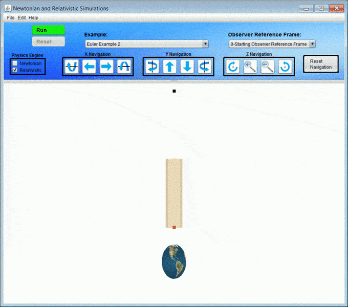

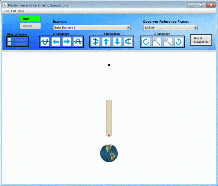

I’m looking for feedback with respect to an SR “paradox”. I’ve gotten myself into a dialog with an Anti-Relativity activist. I know I’ll hate myself in the morning but I thought I would at least make an attempt at explaining this “paradox”.
You may be familiar with it. It goes like this.
There is a spaceship traveling at some relativistic horizontal velocity with respect to Earth. In the spaceship is a pulse beacon positioned some distance above a long vertical pipe. At the bottom of the pipe is a light sensor wired to an explosive. From the reference frame of the spaceship, when the pulse beacon flashes, it will create a spherical light wave front that expands at speed c. Some of the light will travel directly down into the pipe triggering the explosion. The file Ref_Frame_Space.gif is intended to show this arrangement (without the walls of the spaceship). I am using a faceted circle for the wave front to make it obvious that a specific part of the wave front enters the top of the pipe and travels to the bottom without needing to go through the walls.Now consider the situation from reference frame Earth. The spaceship, pulse beacon and pipe are all moving horizontally. The beacon and pipe remain vertically aligned. Now, when the beacon flashes, from the point of view of Earth, the expanding wave front is at rest with respect to the Earth. It is centered at the location of the beacon at the time of the flash. The file Ref_Frame_Earth.gif is intended to show this arrangement. Note again that a specific facet of the wave front enters the top of the pipe and travels to the bottom without needing to go through the walls, just not the same facet as before. I’ve varied the elevation of the pulse beacon and I always get some part of the wave front making it down the pipe, just different parts.Anybody know how to run the gif files? They don't seem to run for me.
So, two questions:
1. Are the gif files consistent with relativistic physics?
2. Assuming they are, what are my chances that I can persuade an SR skeptic with them?
If you track light rays, you'll find that angular aberration means that it is the same photon going down the pipe. The phenomenon is essentially the same as raindrops falling straight down a pipe, but making a sloped streak on the window of a moving car.
Your chances of persuading someone who is convinced that relativity is wrong that it is not are pretty much zero in my experience. If you present maths you're a mathemagician. If you present a diagram or description it's not rigorous and you're just spouting dogma. Good luck, though...

Oh. I may be seeing the light at the end of the tunnel.
Before I read the PeterDonis post, I wrote (but had not yet posted) this reply to Ibix.
With regard to Ibix “raindrop” comment, this is where I start to have problems. I understand how to transform the position and velocity of objects with mass when switching reference frames. But light doesn’t follow those rules, does it?
For instance:
Suppose a raindrop exits the bottom of a leaking bucket at .99c and falls through a vertical pipe positioned somewhere directly below the bucket. If I switch reference frames to one that has horizontal velocity .5c with respect to the pipe, in the new reference frame the bucket, raindrop and pipe will all have a horizontal component to their velocity of -.5c. The raindrop will lose enough of the vertical component to its velocity to make sure its total magnitude is less than c and also make sure the angle of its travel intersects and passes through the pipe. This much I know. I do these kinds of calculations in my 3D computer program a lot.
But I’m stuck because light does not transform like matter.
Suppose a light ray at the south pole of an expanding light sphere passes through a vertical pipe positioned somewhere directly below the light source. The light ray has only vertical velocity. If I again switch reference frames to one that has horizontal velocity .5c with respect to the pipe, in the new reference frame the pipe will again have a horizontal component to its velocity of -.5c. But not the light ray. In the new reference frame I must consider the center of the light sphere to again be at rest which means the ray at the south pole must still have only vertical velocity. If that ray acquires any horizontal velocity, the other rays must also and the center of light sphere will be moving/distorting with respect to the new reference frame. And that’s not supposed to happen. I don’t understand how the ray at the south pole can go through the pipe when analyzed in the new reference frame.
Am I repeating the same misconception about which you guys are writing?
But it won't be "the ray at the south pole" that will get through our vertical pipe. The ray at the south pole in the old frame of reference won't be at the south pole in the new one.

Just to clarify, I understand that I need to take aberration into account if I have a continuous stream of light whose source is moving with respect to me. But I’m trying to model a light pulse, one of very short duration, as a thin expanding spherical shell of light. If the light ray at the south pole of the shell as identified in one reference frame is not at the south pole with respect to another reference frame, how do I transform the locations of the light rays from one reference frame to another? I know I have to end up with another sphere. Different radius is OK but changing the radius won’t change the location/direction of the south pole ray. Rotation?
Think of your pipe with a laser pointing down it. Emit a pulse from the laser - it goes down the pipe.
Now think how that looks from a moving frame. The pipe is moving perpendicular to its length. The light pulse must also have motion in that direction to be going down the pipe. So the pulse cannot be traveling straight down in this frame.
This is true in Newtonian physics as well - raindrops falling straight down in the road frame are falling diagonally in a moving car's rest frame. But the raindrops are moving faster in the car's frame. At relativistic speeds, though, time dilation and length contraction come into play. And for light, they make the speed constant.

You can just use the Lorentz transforms. The pipe is at x=0, -1>y>-2. A light pulse is emitted at the origin at t=0; its position in general is x=0, y=-ct. Use the LTs to show that the pulse enters the pipe in any frame and moves at c in any frame.

Yeah, the rays will get a little boost in the direction of the horizontal movement (of the source of light), but since the magnitude of the speed of each ray should stay the same (speed of light) their vertical components will change too, and the effect will be that of a rotation (in the direction of movement). The south ray won't be the south ray anymore. I'm not sure what you mean by "different radius", the sphere is still expanding at the speed of light in every (inertial) frame of reference.
If you draw the picture of the resulting "sphere of rays" you'll also notice an additional effect - if we have a perfectly isotropic sphere of light in the original frame (where the source of light is initially at rest), in the "moving" frame of reference the sphere is not isotropic (in terms of rays distribution), there is more light on one side (in the direction of the movement of the source of light), than on the other side.
You can also notice that since the tube is moving too (in the "moving" FoF), by the time the expanding sphere of light reaches it, the tube won't be directly below the center of the sphere (which, since the speed of light is constant, is at rest even in the "moving" FoF) of light, and the ray that will reach the tube will be slanted (the old "south pole" ray). Since it's slanted, it has lower vertical speed, and it will take it more time to reach the tube, than it takes him in the original FoF (where the tube is at rest). Time dilation at work.

Do these animations look right?
I posted 2 gifs on my website showing the behavior of some photons originating at the center of a square spaceship and spreading out till they hit the walls.
AstronautObserver.gif shows the behavior from the point of view of an Astronaut on board the ship.
Link is:
http://www.relativitysimulation.com/Gifs/AstronautObserver.gif
EarthOberver.gif shows the behavior from the point of view of an Earth observer for whom the spaceship is traveling easterly at .866c.
Link is:
http://www.relativitysimulation.com/Gifs/EartgObserver.gif
EarthOberver.gif is the result of a relativistic reference frame transformation of all the objects in AstronautObserver.gif. In both animations the photons hit the same places on the walls. In both animations the geometry of the photons appears to be an expanding circle Edit: --> centered at the origin of the pulse ( wrong-->in the middle of the spaceship). The gifs were created by taking screen shots of an example I built in my simulation application. The gifs are crude. The movement in the simulations is much smoother (and flexible). Unfortunately I don’t have the simulation program in good enough shape the make it publically available.
