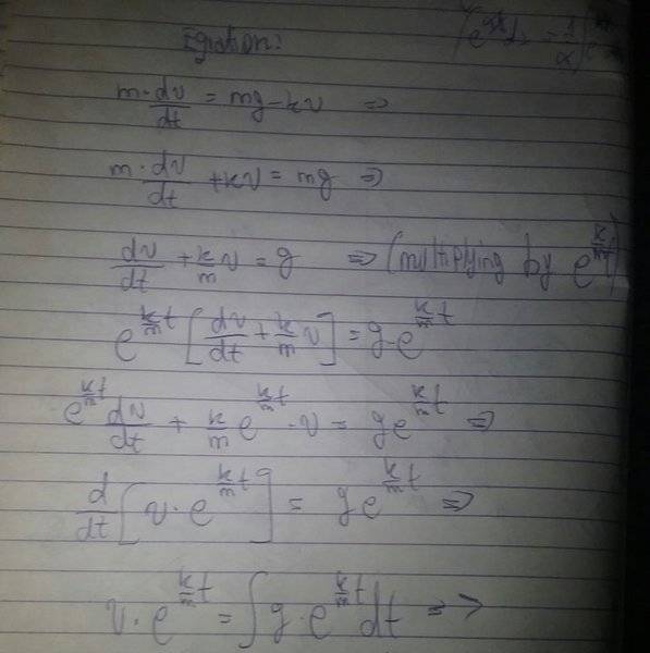

$$m\cdot\frac{dv}{dt}=mg-kv$$
Is a differential equation, if you solve it you get that function v (t)

Thank you all for your responses and your time, you helped me a lot.. I understood the problem
