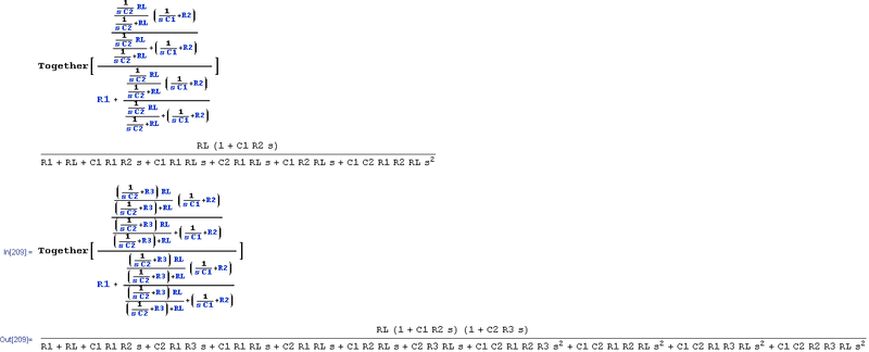

It looks like you got the rather complicated expression for the transfer function correct, but you made a mistake somewhere when you tried to simplify it.

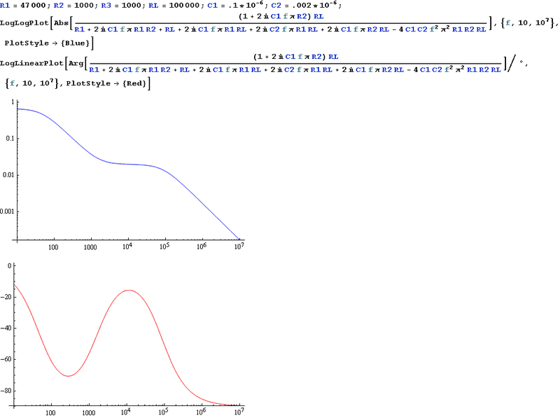

See the first attached image showing the correct simplified expression, and also the expression for the case where an additional resistor, R3, is in series with C2.
The second image shows the log magnitude and phase of the transfer function. I've got a value of R3=1000 there, but it's not used in this plot.

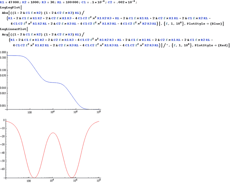

The third image shows the same for the case of R3=30 ohms in series with C2.
The transfer function denominator only involves the variable s to the second power, so you can use the quadratic formula to determine the poles of the denominator, which are the zeros of the transfer function. The poles of the numerator are obvious by inspection. Knowing the poles and zeros, you can plot the asymptotic response (the Bode plot).
I don't understand the bit about the phase lag limits being 50+-, since the phase shift only goes negative. I suppose one way to get the values of R1 and R2 for some specified phase shift would be to manually tweak the values and repeatedly plot phase shift.
But, if your instructor wants precise values, you're going to have to differentiate the expression for phase shift, find the two frequencies of maximum negative phase shift and using those expressions, set them both equal to 50 degrees (or whatever your instructor wants), and solve for R1 and R2.
