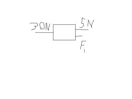

Help with finding missing quantities on Free-Body Diagrams
In the discussion, the user seeks help with calculating missing quantities on a Free-Body Diagram, specifically FNet, acceleration (a), and force (F1), given that velocity (V) is constant. The user notes that the body is not accelerating, implying that the net force (FNet) acting on it must be zero. The relevant equations indicate that FNet equals the sum of all forces acting on the object, which should balance out to maintain constant velocity. Despite reviewing class notes and the textbook, the user is uncertain about how to proceed with the calculations. Understanding that the forces must balance is key to solving for the missing quantities.
bunk66
Fill in the missing quantity for the following:
V = constant
FNet = ?
a = ?
F1 = ?
FNet = Fn - Fg + Fa - FF
Fg = mg
FNet = ma
Because I honestly do not know how to go about solving this, the only things I've done are review class notes and consult the textbook, both of which have left me empty-handed.
The diagram is rather crude, but I'll assume:
- all force lines are supposed to have arrows pointing away from the block
- all force lines are parallel
- the body is not accelerating
If the body is not accelerating, what do you know about the (vectorial) sum of the forces acting on it?
