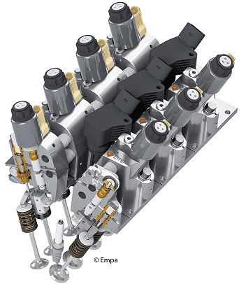

Since the technology exists already, have you looked at existing electric valve actuators? That might be a good place to start, to see how they are built and used...
https://en.wikipedia.org/wiki/Camless_piston_engine
https://www.greencarcongress.com/2019/08/20190820-empa.html

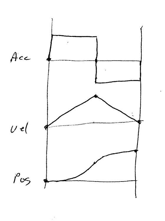

Start by making some assumptions to do some ball park calculations:
Assume the valve stem is 0.5" diameter and 6" long.
Assume the valve face is 2" diameter and 0.3" thick.
Assume that the moving mass of stuff attached to the valve is equal to the mass of the valve.
Assume the valve is the density of steel.
Then the total moving mass is 1.2 lbs.
Assume that valve travel from closed to fully open is 0.5".
Assume engine is designed to run 1500 RPM.
Assume that the valves need to open or close in 90 degrees of engine shaft rotation.
Then the valves need to move 0.5" in 10 msec.
Assume a simple triangular velocity motion profile as shown in the sketch:
It moves 0.5" in 10 msec by accelerating for 5 msec and decelerating for 5 msec.
The acceleration is a = 2*d/t^2 = 2 * 0.25 / 0.005^2 = 20,000 in/sec^2.
The force to move the valve is 20,000 / 386 * 1.2 lbs = 62 lbs.
Assume that the cylinder pressure is 100 PSI at the instant of exhaust valve opening.
The force to open the exhaust valve is 3.14 in^2 * 100 PSI = 314 lbs.
Total force required is 62 + 314 = 376 lbs.
Add a safety factor, design for 500 lbs force.
Assume a peak magnetic field strength of 1.5 Tesla.
That's about 130 lbs pull per square inch of pole area.
You need pole area 500 / 130 = 4 square inches.
Now assume a concept design, such as:
This design has two electromagnets. One pulls the valve open and decelerates the valve when closing. The other pulls the valve closed and decelerates the valve when opening. Not shown is a position feedback device so the controller knows the valve position.
Now you need to design the electromagnets for 1.5 Tesla through a 0.5" physical gap. The magnetic air gap is 1.0" because the field goes from the electromagnet, through the air, through the valve actuator, then back through the air to the electromagnet.
To give an idea of what the electromagnet will look like, I once designed an electromagnet that pulled 1600 lbs force through a 1/8" air gap, and turned on and off 55 times per second. The duty cycle was approximately on for 9 msec, then off for 9 msec. Peak current was 50 amps, and it needed about 170 volts to meet the di/dt requirements. The drawings in US Patent #6,389,941 of this electromagnet are only approximately to scale, but you can get an idea of the magnet size from the drawing. The knife cylinders are 10" apart on center, and the electromagnet stack was about 4" thick. The laminations were 0.014" thick steel of a special magnetic alloy.
