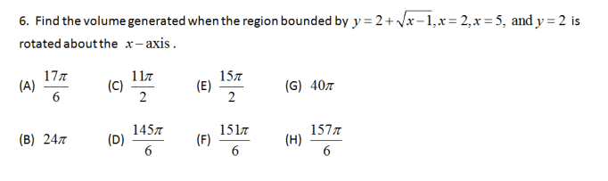

The problem is attached in this post.
I used washer method and set my outer radius as 2+2+√(x-1) and my inner radius as 2. I set my upper limit as 5 and my lower limit as 2.
I set my integral as π∫((4+√(x-1))^2-(4) dx, from 2 to 5 = 485π/6 which is incorrect, the actual answer is 157π/6.
Hi student93!
Why do you set the outer radius to 2+2+√(x-1)? Outer radius is simply 2+√(x-1), do you see why?
Could you please explain why that's the value of the outer radius? Also is the value of my inner radius correct?
Draw a graph and select a disk, it becomes clear why the outer radius is that.
Yes. :)
