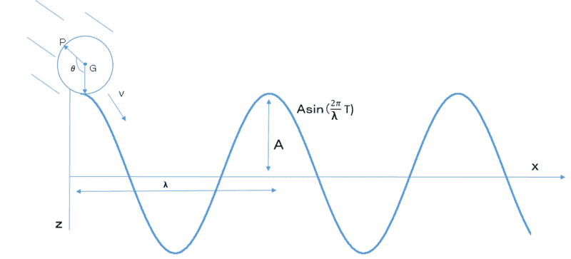

Hello guys, i`m currently making simulation of 2 dimension rolling disk on elastic sin/cosine plane. I`m just wondering if the theory applicable.
What is a sin/cosine plane? We need a definition/description here before there can be a useful answer.
so sorry, i forgot to add the figure
something like this, but the cos surface is elastic and the disk is solid object.

I cannot see any reason to doubt the applicability of Hertz' theory here.

its settled then ! thank you :smile:
