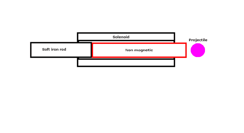

I am designing a project that requires propelling a very light object (milligram weight) to speeds of 2 or 3 meters per second is this possible? Small size and voltage of solenoid a big plus.
Too little information. Of course it is possible, after all your electric motors run on solenoids. But the real questions are:
What material is the object made of? Why are you thinking about a magnetic system? Can the object be in contact with a lever? Is there friction? Over what length do you accelerate? Are you accelerating against gravity? Will the object carry its own solenoid? Will the object be made of metal? Does the object need to stay at that speed or can it be pulled against a magnet? I imagine with a large niobium magnet iron particles could reach that speed on the last mm. 100 km/h is not that fast.
You could try something like this:
A solt iron rod is pulled into a solenoid when power is applied.
A non magnetic or insulating rod, attached to the soft iron, protrudes out of the other end of the solenoid.
This hits the projectile with a lot of force projecting it off to the right in the diagram.
