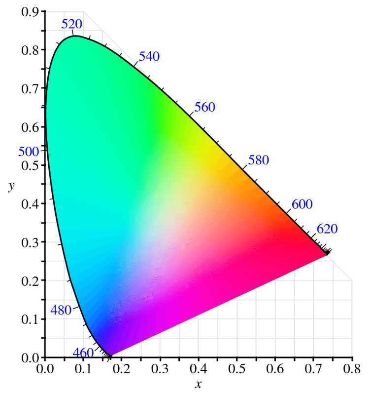

As far as I can tell, this image from the wiki on "spectral colors" meets your required level of precision. If you want to pick off the values, you can do that with pretty much any photo editor. All caveats discussed above apply.

@Teck Note that the above is the PNG version generated by PF. The original version has smooth transitions:
https://en.wikipedia.org/wiki/File:CIE1931xy_blank.svg

Thanks but that picture is not what I'm looking for. The picture needs to be a 1D line graph. Actually, even a 360x2 array with just integer wavelengths and corresponding color codes would do.

I doubt you will find this already made. You may have to spend an hour constructing it yourself from that data.
Edit:
Ehh, someone had to have made that graph. You may be able to find the data and/or equations behind it. But it still might be faster to generate it yourself.

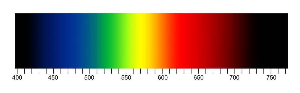

Here you go. It may take a while, but you can get RGB values from this wavelength-to-RGB value calculator: https://www.johndcook.com/wavelength_to_RGB.html
I have no idea how accurate this is unfortunately.

The data is on the graph. All you have to do is read it (with a photo editor) and type it into a spreadsheet/table.

I'm not sure I understand that; is the output hexadecimal? Converting their sample to decimal gives a 7 digit number. I would think the OP is looking for 3, 3-digit numbers. I guess I'm not clear on how that is stored in a bitmap and how it translates, if that's what it is...

Thanks, I will check and compare how accurate it is.

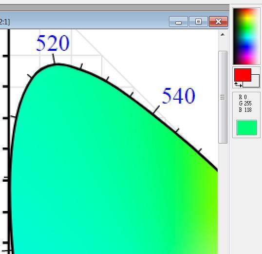

No, I mean literally read off the screen with your eyes and type into a table with your fingers. E.g., I just opened the file in a 20 year old copy of Paint Shop Pro 4.12, which you should still be able to download from somewhere. But literally any photo editor worthy of the description can do this:
-Hover cursor over a point on the edge of the graph. For example, 540nm
-Read the data from the color pallet on the side of the screen: 0, 255, 118
-Type it into an Excel spreadsheet
-Repeat
Edit:
The cursor wasn't included in the screenshot, but here's what it looks like when I hover over the edge of the 540nm hash, just off the black line:

Oh, you seem to have missed that I asked for a graph that maps every visible wavelength integer to an exact colour code. "Point and click" on a low resolution image is not that. Especially not one that is uneven and squashed together at the ends.

The smooshing together at the ends is a feature, not a bug; our color vision doesn't cut off cleanly and so the palette makers don't bother to assign as many values. And looking at the values, right up to 640nm you can do better than 1nm resolution. E.g, at 620 through the end of the scale, the red and green are 255 and 0. Blue is 53 at 620nm and 75 at 640; 22 steps for 20nm and you can interpolate or pick the nearest for each. The scale ends at a blue value of 83, so that's all the rest of the red end of our vision in only 7 steps of rgb values.
In most of the rest of the graph however you can do half nanometers per rgb value if you want to get that fine.
I'd be curious about why you want this level of precision too: again, the accuracy of this data is much lower than the precision you are going for, so there probably isn't much to gain from single digit nm vs, say, 5 nm precision.
To reiterate the accuracy problem, there are several issues:
1. Different people perceive and/or sense them differently.
2. Different monitors display them differently
3. Different color spaces are mapped differently.
That last one I'm not sure was made clear. The image I gave was one of many options:
https://en.m.wikipedia.org/wiki/Color_space#/media/File:CIE1931xy_gamut_comparison.svg
Each will give different rgb values for the same wavelength and most even cut off sooner, eliminating the smooshing problem at the ends by stopping sooner.
