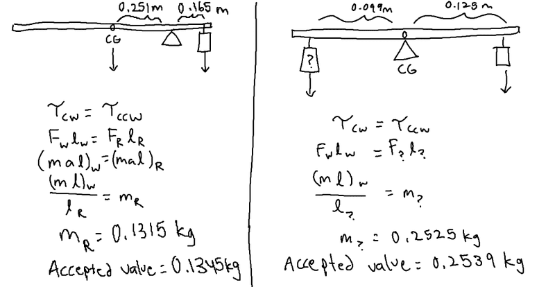

Scoli Messages 1 Reaction score 0 Thread starter Apr 16, 2015 #1 Homework Statement [/B] Known weight: 0.2 kg Center of gravity: 0.501 m Other found data is in the drawing I made below Homework Equations [/B] T=Fl 3. The attempt at the lab
Orodruin Staff Emeritus Science Advisor Homework Helper Insights Author Gold Member 2025 Award Messages 22,832 Reaction score 14,879 Apr 17, 2015 #2 Your work is fine, but I seriously doubt that your measurements are precise enough for you quote your result with four significant digits.
