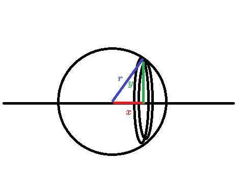

I need to find the moment of inertia of a sphere of radius ##r## and mass ##m## about an axis through it's centre. I've already done it and got the correct answer of ##\frac{2}{3}mr^2## however I have tried doing it using a different method to see if I get the same answer, but I don't, and I don't know why.
See the image attached.
The moment of inertia of one of the hoops is ##\displaystyle\frac{m}{4\pi r^2}\times 2\pi y \delta x\times y^2##.
##x^2+y^2=r^2## so I just need to evaluate ##\displaystyle\int_{-r}^r \frac{m}{4\pi r^2}\times 2\pi (r^2-x^2)^{3/2}\,\mathrm{d}x##
But I don't get the right answer.

Seems like your expression for the hoop moment of inertia is wrong. It should be [tex]\frac{m}{4\pi r^2}\times 2\pi y \sqrt{(\delta x)^2+(\delta y)^2} \times y^2[/tex]
Sorry, I forgot to add it. It's just showing what my x,y, and r mean.
Wouldn't the width of the hoop just be ##\delta x## ?
Yes, but the mass of the hoop is proportional to its surface area which depends on both δx and δy.
just imagine for a second a hoop where δx is zero, but δy isn't. You get that when calculating the Moment of inertia of a disc. The expression you had is good for hoops taken from a cylinder, but not for hoops taken from a sphere
Ah, I understand. This method won't work then, the previous one involved ##r\delta\theta##.

The method works, but you first must find an expression for δy by implicitly differentiating the expression for r2, and setting it to zero since r is constant. The other method you describe is using the volume of a disc, not its surface area.
I know, but I'm wondering why it's OK to approximate the width as ##\delta x## to find the volume, but not to find the surface area.
δx is the width of the slice, so that is the correct factor for the volume (not an approximation). The slice doesn't reach the surface of the sphere at a right angle, so the width of the ribbon taken by the intersection of the disc with the sphere's surface is different from the with of the slice itself.

In the case of the hollow sphere, the ribbon would also be an infinitesimal slice, so I don't really understand why ##\delta x## wouldn't work in that case, when the approximation(which it is, at least before the limit is taken) works in the case of the solid sphere. I'm not understanding the difference between the two cases.
The difference is that in one of them you're calculating the volume and the shape of the edge doesn't matter. In the other you are calculating the area of the edge and its shape is crucial.

GeneralOJB said:
The moment of inertia of one of the hoops is (m/4.pi.r^2)*(2.pi.y.dx)*(y^2)
no it is not because
surface area of hoop element= slant height * circumference
(not vertical height * circumference , as in your expression)
so moment of inertia of one of the hoops
=(m/4.pi.r^2)* ( dx . sec(t) . 2.pi.y) * (y^2) (where t is angle bet axis of hoop and line parallel to slant side surface of hoop)
tan(pi-t)= (-x) / ((r^2-x^2)^0.5)
so tan(t)= (x) / ((r^2-x^2)^0.5)
so sec (t) can be found
final exp for moment of inertia of one of the hoops = (m * (r^2 - x^2) * dx) / (2* r)
integrate from -r to r you get (2/3)m(r^2)
