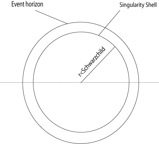

  • #61
chronon said:
OK I see now. Its like to joining up lots of little black holes into a spherical shell.
I don't think that comparison works. To create a truly continuous 2D surface you'd have to join up an infinite number of pointlike singularities, and if each has a finite mass, the mass of the surface will be infinite. In contrast, a 2D surface of infinite density can have a finite mass, while each point on that surface will infinitesimal mass.
My point is that you can't squash a surface down to a gravitational singularity. Either there's enough mass present to form a 'normal' black hole, or you don't get a gravitational singularity - that is gravity won't take over to continue the flattening of the surface down to zero thickness the way it does in the 3D case.

  • #79
There does exists a solution for a collapsing thin, pressureless, spherical shell of matter. Outside the shell, spacetime is Schwarzschild, inside the shell, spacetime is Minkowski.
References: Poisson's book, section 3.9; Israel, Nuovo cimento, 1966.
  • #80
Again, Instine isn't talking about a spherical shell of matter with finite volume. He's talking about a weird form of 2D singularity with zero volume but finite area and mass (and therefore infinite density, just like a point singularity or a ring singularity), shaped like the surface of a sphere. I still am not sure whether such a thing would even be allowed in GR, and even if it is there may not be any way it could form naturally.
  • #81
My short description was not very clear, but this is what I mean. It's similar to electromagnetism, where a surface charge density is an often-used and useful approximation to physical reality.
  • #82
Suggestion: try thinking about the Newtonian case first.
Some suggested thought experiments:
1) Using Gauss's law, calculate the surface gravity of a spherical shell of total mass M and radius r. Show that the result depends only on the total mass M and the radius r - that it is not a function of the thickness of the shell, or the density. Show that the result for the surface gravity is finite if M and r are finite.
2) Because the surface gravity does not depend on the thickness t, taking the limit as t->0 is trivial. If the shell is very thin, show that the surface gravity remains finite, even as thickness approaches zero.
2a) If you want extra convincing, try figuring out the gravity of an infinite plane sheet of thickness t and density rho. Show that it depends only on the product of rho*thickness specifically
acceleration = 2*Pi*G* (rho*thickness)
where rho is the density / meter^3, and thickness is the thickness of the disk in meters.
3) Calculate the escape velocity for the sphere in addition to the surface gravity. As long as the Newtonian escape velocity is << c, one expect that Newtonian gravity will work just fine.
4) Make a rough order of magnitude estimate of when the object will become a black hole by computing when the escape velocity reaches the speed of light.
5) For a full GR treatment -- consider that Birkhoff's theorem says that any spherically symmetric vacuum solution of Einstein's equation will be the Schwarzschild solution. Re-read George's response with this in mind.

This is a very hard line to ballance upon, but now you guys are not being philisophical enough.
I'm not interested in the matematical solution. As it is not the maths I'm worried about. I'm worried that FP is in a universe surrounded by singularity, BUT there is not enough information in that universe to describe the singularity, and thereby proscribe what happens next.
So again, can anyone say what happens next, as seen by FP.
Again the silly graphic.

OK
I've been pondering this, on and off for many years and only now does this strike me. There woould be no inner event horizon!
Causing a naked singularity!
Again thanks for the chats you fellas. It was only describing it, that made me see this.
  • #89
This requires a new silly picture:
