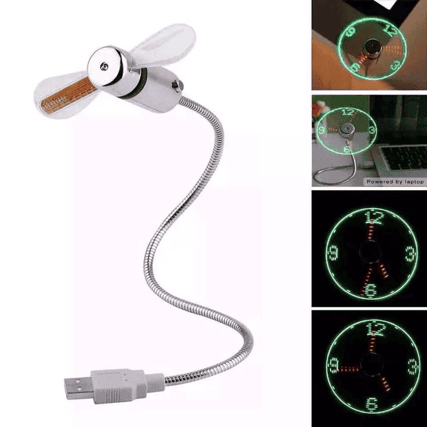

I dunno; probably just an advertising trick. I have seen similar design used on a handheld fan which had embedded LED arrays ages ago. I assume this is just a scale up version of the fan I saw:

I don't see any holographic effect there. It is just persistence-of-vision -- very much like a differing light patterns being projected on a screen can give the illusion of movement, that approach is commonly called a "Movie."
(Or in this computer age it is called a "Video.")
The images in the demonstration were most likely computer generated... that would be an awful lot of work to do manually!
Your skepticism is well founded, Well Done!

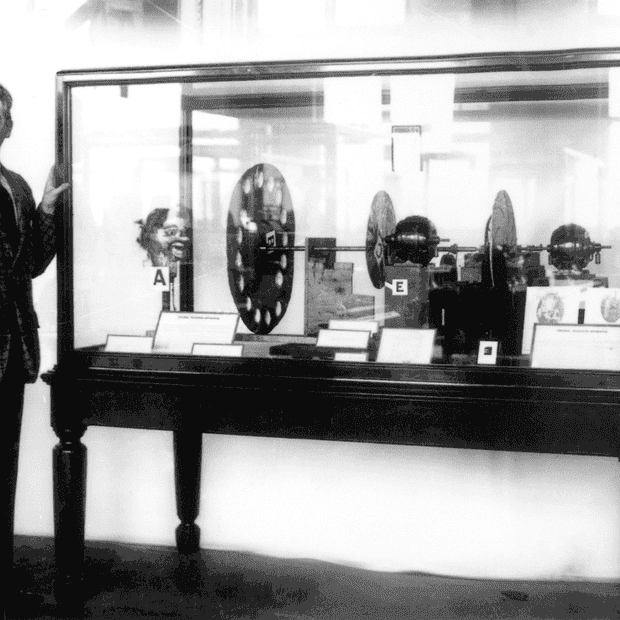

This seems to be a mechanical TV display, similar in principle to those used in the 1920s. It is almost transparent because we now use thin arms with tiny light emitters that are invisible once the device is rotating. Unfortunately the display has a motor in the centre, making it unsuitable for ordinary use. In the 1920s this device would have required a rotating switch for the row of lamps on each arm, which was impracticable.

This?

Yes, I also had the pleasure of meeting Victor Miles, who built the equipment for Baird. The first successful display used 12 flashlight bulbs around a disc, powered by a 10 watt audio amplifier. Such an amplifier was expensive and difficult in the 1920s. In the camera which is in the photograph, the light is chopped by a slotted disc. This was intended to avoid a DC component on the video, as the selenium cells then used had a very poor high frequency response. The equipment was the first to display a motion picture with half tones, as previous attempts had given black and white images.
