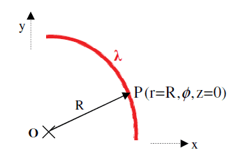

Does it mean that if the arc is 1/4 and not 1/2 , it will have both x and y component ? since there is no symmetry ? correct me if I am wrong
I don't know what you mean. It's not the size of the arc, it's the symmetry.
What I mean is something like this? In this case , it will have both x and y component since there is no symmetry. Correct or ? am i wrong?
The symmetry will be about a line from the point O to the center of the arc. Since that's not along the x or y axis, there will be an x and y component.
I see thank you.
