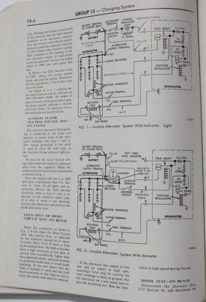

You're right on the money. My alternator gauge is smoked. Got a live reading (from the test light) on the lug nut with the heavy duty alternator gauge wire, but nothing from the other lug nut.
I have to order a new gauge from the States. It will take some time to get here, so I will post back in a couple of weeks with all the other suggested "tests" results.
  • #42
According to the wiring diagram from themustangshop that I posted earlier, there is a yellow and a red wire going to the ammeter. Both of these wires go to the same plug (different terminals) then both end up near the battery side of the starter solenoid. They do not connect to any other wires.
It was the black wire that you said was crossed with the oil pressure wire and did the damage, so it had power then! Did you forget to install it when you had the wires off the starter solenoid? If not you should trace the wires back to see why you have no power.
It sounds like all you have is a test light, is that correct? With an ohmmeter you could disconnect the battery and read across the ammeter and check it before ordering a new one.

Nucleus, if there are large heavy wires that attach to the ammeter gauge, then the shunt is internal the same way it is on a multimeter. You should never ever ever ever ever have power on one side of an ammeter and not on the other. If this is the case then the ammeter is toast. Getting power through an ammeter of any kind only requires that the shunt is intact whether it is internal or external. It does not matter if the 'millivolt gauge' as you call it is even in circuit. Nucleus, so far I think you have only confused the OP.

This is your OP speaking Nucleus. By the way, what does OP mean?...Other Person? Other Party? or Outside Party?...Please clarify. I was waiting for the mud to settle before speaking with you.
This is the wiring setup to the alternator gauge and the oil pressure gauge as it stands now.
1) ALTERNATOR GUAGE: Looking at the back of the gauge in a normal upright position -
Left lug/post = small red and violet wire Right lug/post = heavy duty "live" black wire
Bottom lug post = a ground wire

Bigblock, do you understand the drawing in post number 4 in this link: http://mustangforums.com/forum/classic-mustangs/596726-amp-gauge-wiring.html
I think nucleus and I have come to the conclusion that it uses an external shunt. However, you still should show power on both sides of the ammeter. The yellow hilighted wire in the drawing is considered the shunt and the gauge in your dash measures the voltage dropped (lost) in that section of wire. Seems impossible at first but it is so. You should be able to see from the drawing that the gauge itself is not required for your vehicle to operate. I may have slightly misinformed you in the past and am sorry for that. So can you see how the yellow hilighted wire could cause what you are experiencing if it were burned off? The logical place to start of course is under the dash. However, the smoke you seen from under the dash could have come from the gauge AFTER the shunt was burned open under the hood. I would think this would put a full 12 volts across the gauge in your dash and could cause damage.
Would you agree that disconnecting the main disconnect connectors shown on the diagram should NOT cause a loss of power at the main alternator lug? Maybe you should do this and troubleshoot from there? It would be a bit easier to keep it straight in your own mind knowing to ignore everything under the dash.

I think you have missed the point. I clearly stated that you don't even need the gauge installed for your vehicle to work if the system uses an external shunt which nucleus and I have come to the conclusion that this is the case. I may have misinformed you earlier while thinking that there was no external shunt and that ALL the current has to pass through the gauge itself and am sorry for this. The test that shows power only on one side of the gauge is still a valid test and indicates something is open somewhere. I cannot tell you if your description of wire colors is correct. I can only go by what I know from experience and what is drawn in the link that nucleus was nice enough to post. So if you are willing to agree that the drawing I refer to is valid, can you see why I ask you to forget about what is going on under the dash for the moment and look at the hilighted yellow wire in the drawing in the link? http://mustangforums.com/forum/classic-mustangs/596726-amp-gauge-wiring.html
Do NOT bypass the gauge itself under the dash. One wire that connects to it is not heavy enough to carry the load based on your description of said wire. You need to be concerned with the yellow hilighted wire in the diagram.

Averagesupernova was kind enough to supply the wiring diagram.
Let us start at the battery..one side is ground ( triangle like symbol) to other is the hot (+ ) side. It is connected to the starter solenoid or relay with a big number 2 cable bolted to a huge lug. On this lug are two additional wires..see diagram..625 that runs to your Ammeter and 37 (yellow) that runs to junction connection where one side splits off to the alternator (37 red) one wire runs to the main connector and wire 654 blue one wire runs to the Ammeter... THRU and fuse or fusible link as indicated just after the junction...) The ammeter is a meter that indicates if the alternator is charging and in order to work it must be in series or in line with the circuit so the alertnator puts out voltage (V=IR) and the current is displayed on the gage.
Back to the STARTER - the starter has one ground wire ( triangle like symbol) and one large number 2 wire connected to the other side of the starter relay.
The starter relay is just a switch activated by 12 volts supplies to the S terminal via the 32 wire. The 32 wire is activated in the turn and hold position of the ignition key. If every thing is operating correctly, when you jump 12 volts to the S terminal, it connects the switch and the starter should spin..like wise if you connect the 12 volt number 2 cable from the battery directly to the large number 2 cable the starter should spin.
The I terminal on the starter relay ( wire 262) is connected to the ignition key ( when key is in the ON position..( when your radio plays) and is also connected to the + side of the ignition coil. ( there is also an Accessory position on the ignition key, opposite of the On position..used for accessories like the radio.This was done to keep idiots from burning out points and ignition coils when they left 12 volts running to these ignition parts for hours while they were trying to get into Mary Jane rotten crotch's pants at the drive in movie).
anyway, you can hot wire the car by simply jumping 12 volts to the + side of the coil and actuating the starter by jumping the two large number 2 cables...

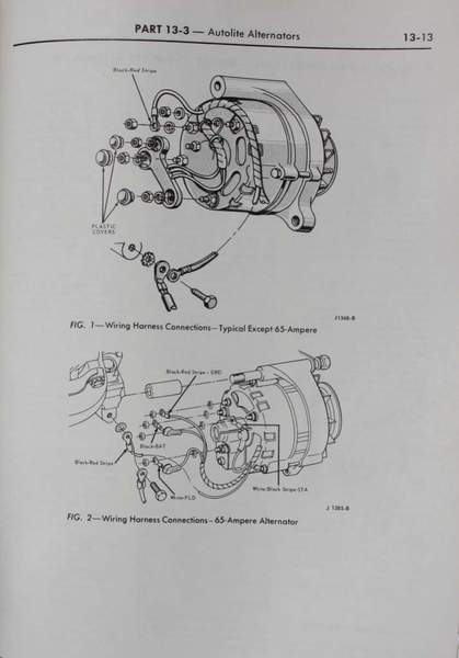

I have been unable to locate the yellow "shunt" wire (#37) under the hood. Next move remove the instrument cluster and check under the dash as well as the constant voltage regulator.
I have bypassed the alternator gauge by wrapping the alternator wires together and insulating with electrical tape (that is HD "live" black wire and the black return wire. The oil pressure gauge has also a HD "live" black wire with a red-white return wire).
I also found 3 wires under the hood that have no continuity at the connector (2 red, and 1 white-red). These are for the coil and oil sender unit, and appear just after a 'disconnect block' of spagetti-like wire. I have spliced and by-passed the bad sections, but the main red still has no continuity.

Yes the external shunt is what you are looking for. Why are you dragging a new diagram into this? The diagram in this link:
shows it just fine. In fact it is in better detail. If this wire #37 is intact you will have power at the large terminal on the alternator even with the connectors on the firewall unhooked. This is where you need to be looking. I don't know what color it is in real life. I know it has to carry complete charging current so I would say back in the day with the size charging system that car had possibly a #8 wire.
Edit: Do you have a reason to believe the diagram in the link I gave is inaccurate?

I have completely rebuilt the alternator wiring harness-brand new (including the shunt). I have power to both sides of the ammeter (unlike in posts #12 and #17). Also, I have power to the large lug (#37) at the alternator (reference post #60).
