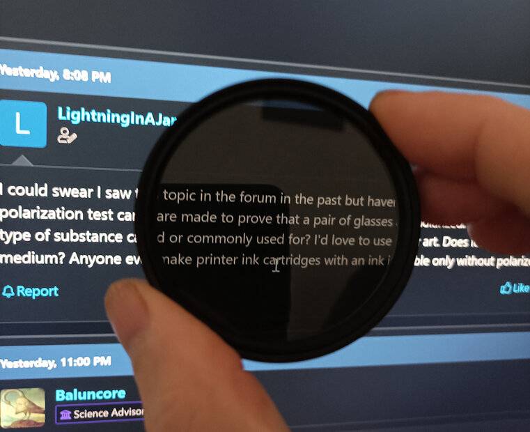

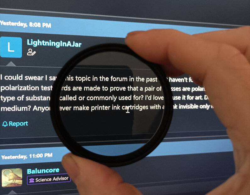

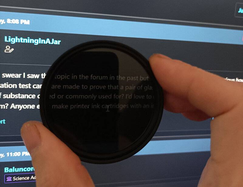

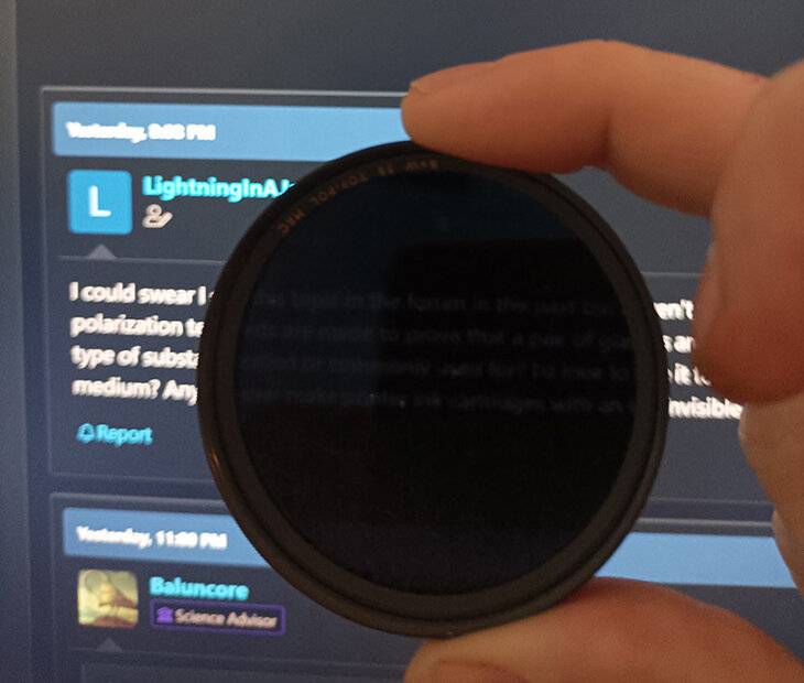

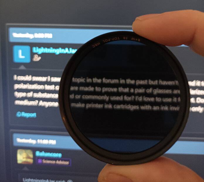

I have no answer to your particular question, but in case you weren't aware of it, I just wanted to say that glasses can often be tested for polarization by looking with them at a screen (tv, computer etc) at different angles. I've noticed this since I often wear sunglasses :smile:.
Regarding linear and circular polarization I just fetched two of of my polarizing filters (one linear, one circular) for camera lenses and tested them on my screen, and they both worked:
1. Linear polarizing filter (at different angles):
2. Circular polarizing filter (at different angles):
