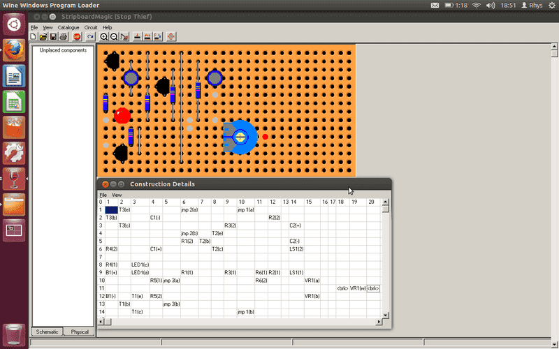

I'm actually using Stripboard Magic to work out the logic for me as I got a couple projects wrong on my own. I've screen printed what Stripboard Magic told me to do however I assumed it got the VR wrong so I basically moved everything on row 10 down to row 11 without the break. This did not work and after your suggestions I put a wire between VR1a and VR1w. This also doesn't work, however when the VR is set to 0 the buzzer changes pitch.
I think I've tried both methods 1 and 2. I've used a sharp knife to score between the strips and checked with a magnifying glass and trippled checked everything is the same on my board as the diagram.
Have I messed up using the VR? Does anyone have a simple schematic that teaches me about VRs and potentimeters etc? Stripboard Magic doesn't like using all 3 points, so something simple I can work out myself would be great. Any suggestions?

yungman said:
It'll work connecting EXACTLY like the schematic, it won't work if only two legs are connected. You need the ground reference to set up an adjustable voltage divider like in the schematic.
We were at cross purposes there. I was, of course, expecting a path to ground.
If I were you I would get the switch working first.
Temporarily connect a resistor between 1k0 and 2k2 from the collector of TR1 to the junction of R4 and LED1.
This will bypass the buzzer and multivibrator, without damaging them but allow TR1 to switch on and off the LED.
Then you can work on getting the switch working correctly.
