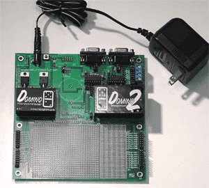

There's no quick way to learn computer basics. Best way is to dive in as you are doing. Take it home over the weekend and plan on a lot of midnight oil.
Start with the examples on Microchip site.
If you are facing a project deadline consider using a BASIC micro instead. The interpreted Basic runs slow but is orders of magnitude easier to learn.
I used one of these for an emergency project -
http://www.micromint.com/products/by-family/modules.html?id=45
Had one week to order parts, design, build, program, debug and deliver. Made it thanks to the Boss's credit card and Steve Ciarcia's advice "Use Basic not assembly" .
