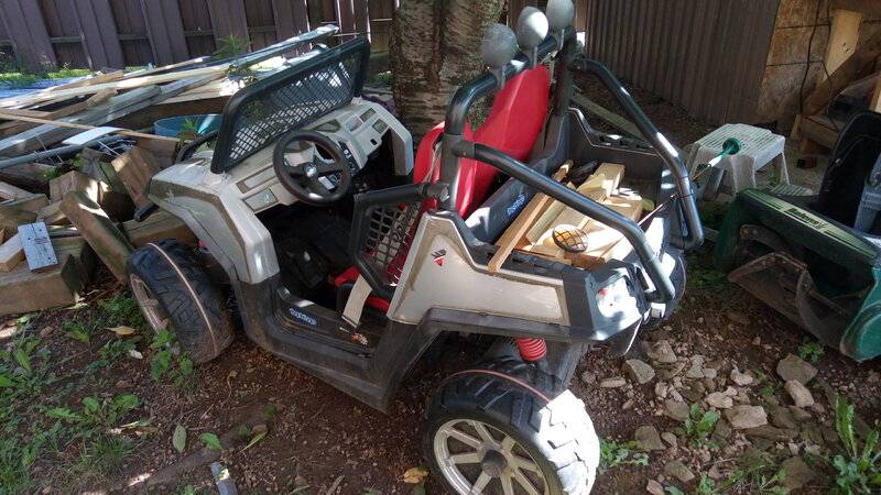

This toy ATV came untested. I want to make sure the motor works before bothering with anything else.
I picked this up for free for my grand-child. It allegedly worked when the previous owners last tried, but it's been sitting outside for at least many months.
It did not come with the charger. No idea of the condition of the batteries. I assume they're dead. I do have a battery charge for my car. Nevertheless, Before I put any effort into it, I should find out if the motor works at all. I want to separate any battery troubles from any motor troubles, so it seems to me I can just hook it up to my car batter(ies).
I found it here online: it says it is 24V.
https://goldtex.ca/products/peg-perego-polaris-ranger-rzr-green-shadow-24-volt-green
So ... I hook up two car batteries in series, right?
Any special precautions? Other than don't electrocute myself, or 'splode it in my face?

Two car batteries in series should work fine to test. You understand that the issue with car batteries is not electrocution (volts) but the fact that they can dump lots of amps if shorted causing lots of heat. Wear goggles/face shield and stout gloves when you first check it out.
Charge the old batteries slowly when you attempt their resuscitation. Good toy!

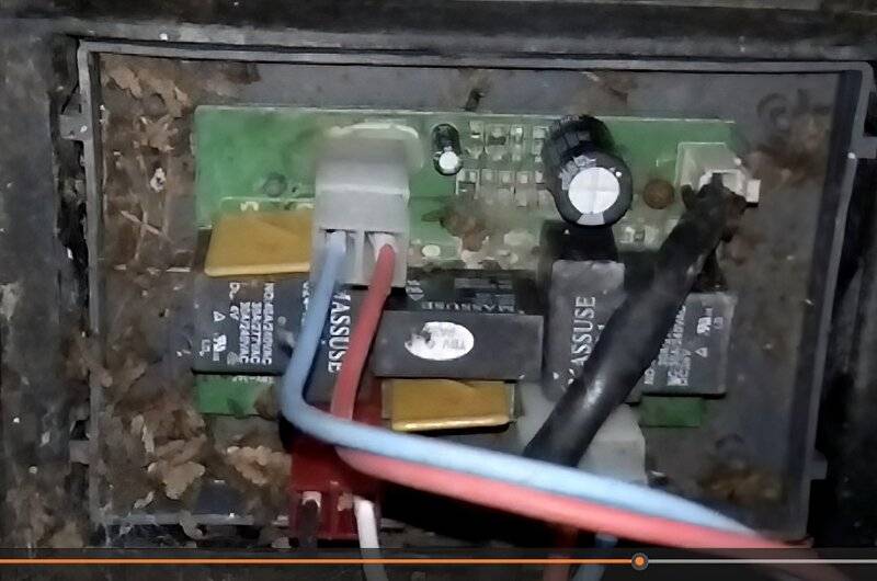

The PCB:​
Circuit board inside a dark plastic housing with several relays, a large electrolytic capacitor, a white connector, and red and blue wires leading out, some covered in debris.
Looks like a couple of PTC self resetting fuses and some relays on that board. Unless a circuit board trace blew open, I'd think there's little to go wrong there. Don't give up on this. I think it can be brought back.

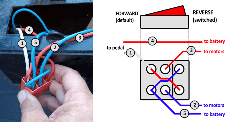

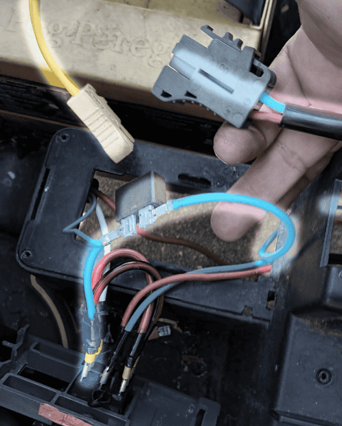

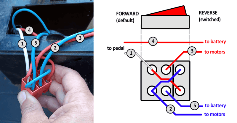

I've narrowed it down to this switch (as I originally suspected). At least for now.
It works in the REVERSE (i.e momentary ON position), but does not work in FORWARD (default OFF position).

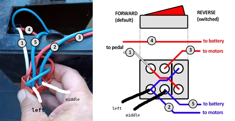

I want to bypass the switch itself to see if I can get the FORWARD to work, but I'm not sure which pin(s) to jump.
Left: photo of a hand holding a red plastic multi-pin connector with numbered white, red and blue wires (1 to 5) leaving it. Right: wiring diagram of a reversing switch with FORWARD (default) and REVERSE (switched) positions, showing wires 1 to 5 connecting to pedal, battery and motors.

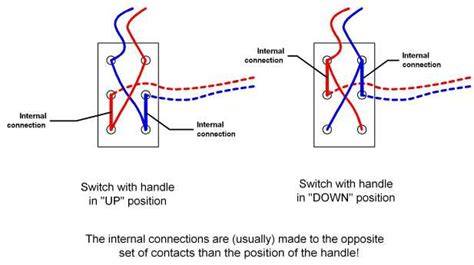

You have an error on your drawing: Numbers 2 and 5 notations are interchanged. (The middle connections go to the motors and the left connections go to the battery.)
The following figure shows the internal connections depending on the switch position:
Two wiring diagrams of a double-throw switch with a handle, showing red and blue internal connections for the UP position on the left and the DOWN position on the right, with captions below each.
So connecting 1&2 and 3&5 together should bypass the switch in the forward direction. 1&3 and 2&5 should be the reverse direction.
Nope.
(5) runs directly to a fuse then to the battery terminal.
Here's a better pic:
Photo of a wiring harness inside a dark plastic housing, with a grey multi-pin connector being held by fingers at upper right and a beige connector at upper left, with blue, red and black wires traced through the assembly and terminated on crimp connectors at the bottom.
In the little research I've done I can see that you are correct - it is not the conventional/correct way to do it. But for now, it is what it is.

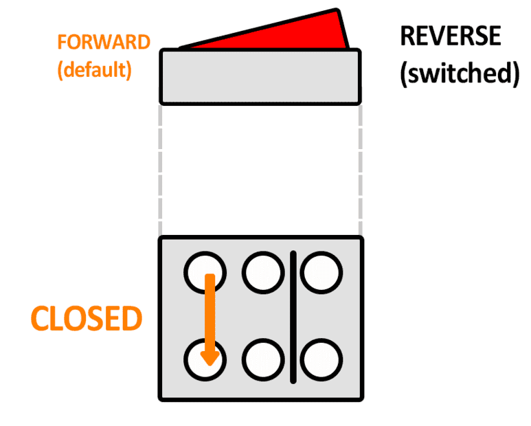

Question:
This is what the switch actually does, yes?
Diagram of a two-position switch: a red tab labelled FORWARD (default) sits on top of a grey block, with REVERSE (switched) on the right. Below is a contact block labelled CLOSED with six circular contacts, one linked by an orange arrow pointing down, and a vertical line dividing the right two columns.
It seems to me, I can
- disconnect the two ON (REVERSE) pins, then
- jump the OFF (FORWARD) pins.
If the motor works, then the switch itself is toast.

Two diagrams of a double-pole switch with a handle in UP and DOWN positions, showing red and blue wires crossing internally between contact pairs; labelled 'Internal connection' and dashed red and blue wires leaving the switch.
jack action said:
I know they go where you say they go, but:
  • On the switch, 5 is on the left and 2 is in the middle;​
  • On the drawing, 5 is in the middle and 2 is on the left.​
Oh. Right. Fixed.
Left: a hand holding a red connector block with numbered white, red and blue wires (1 to 5) on a dark surface. Right: a wiring diagram of a forward/reverse switch with labels to pedal, to battery, to motors, FORWARD (default) and REVERSE (switched).
Now it makes a little more sense. Its still wired up backwards, but at least it's symmetrically backwards. :smile:

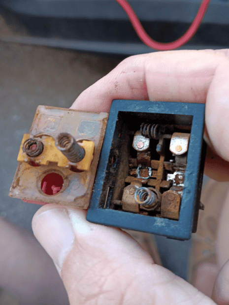

Well there's yer problem mister...
Hand holding a corroded electrical plug with rusty brass prongs and a red-lined hole, beside an open blue plastic housing showing rusted internal contacts and springs.
Looks like I'll be hard-wiring this puppy in forward gear...

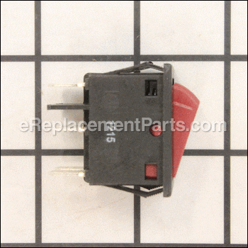

Tom.G said:
A Google search finds many replacement switches, many <$10:
Just make sure they are rated for DC, and preferably for inductive load (hard to find though).
https://www.google.com/search?sca_e...t+50A+rocker+switch&oq=dpdt+50A+rocker+switch
Cheers,
Tom
Yes, I have Googled them muchly.
The catch is that the gear shift is designed to mechanically push on the switch - switch and gear shift are affixed in a framework so they come together just right. I don't think there's a lot of margin for error, so it has to be virtually the exact switch.
(The switch button itself is flat, not concave - not curved or notched - and it is opaque red, not transparent. Too bad I can't just point to a Google pic to show you what I mean...)
Also, it's 2-position, temporary-on. Most of those are 3-position.I have yet to find anything similar online.
OK.
Try inserting the word Momentary between 'dpdt' and '50A'.
Alas...
Even dpdt momentary 20A rocker switch 6 pin 12v brings only tears and heartbreak.
