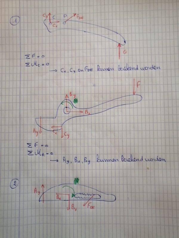

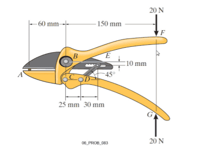

Find the forces in hinches B, C and D.
Sum forces = 0 and sum torques = 0
First subsystem:
$$C_x + F_{DE} \cos(45) = 0$$
$$C_y + F_{DE} \sin(45) + 20= 0$$
$$F_{DE} \sin(45) \times 25 + 20 \times 150= 0$$Second subsystem:
$$B_x - C_x = 0$$
$$B_y - C_y - A_y - 20= 0$$
$$-F \times 150 + A_y \times 60 - C_x \times 30 = 0$$Third subsystem:
$$-B_x - F_{DE} \cos(45) = 0$$
$$A_y -B_y - F_{DE} \sin(45)= 0$$
$$-A_y \times 60+ F_{DE} \sin(45) \times 55 = 0$$Problem is that I have 9 equations and only 6 unknwowns.
  • Diagram of pruning shears with points A through G labelled, 20 N forces applied at handle tips F and G, dimensions 60 mm, 150 mm, 25 mm, 30 mm, 10 mm and a 45 degree angle, and figure label 06_PROB_083.

  • Hand-drawn free-body diagrams of pruning shears split into three parts, labelled with forces Cx, Cy, FDE, Ay, Bx, By, F and G, with equilibrium equations written beside each part.
Some of your equations are redundant. For example, consider the first equation in each subsystem. These three equations are redundant.
Thank you, I see. It was in my mind that all equations were needed. This solves my problem.
