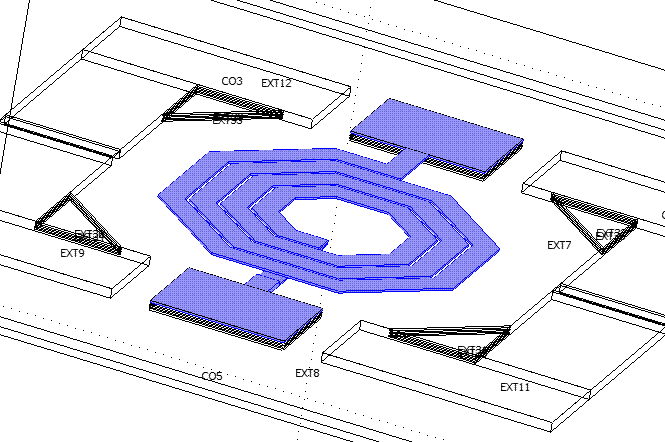

I'm new in using comsol multiphysics and I'm trying to model a spiral inductor which is placed in an another material (glass) which is over a substrate. The pads of the inductor are outside the material. What I'm trying to find out is, the temperature of the surface of the device given given a dc current of the inductor. i don't know which solver to use working with heat transfer by conduction and conductive media dc.
I usually get a message of singular matrix.
Thanks in advance!

A singular matrix is often a sign that something wasn't defined properly in the model. Make sure that the properties of all elements are set properly for all the physics used.
