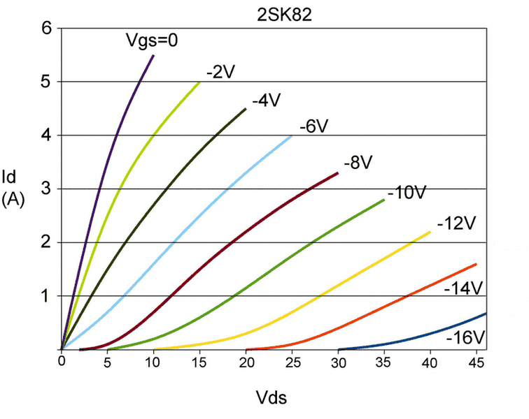

It looks like there is no replacement for the VFETs that were made by Yamaha or Sony. So, if a amp uses these output transistors and they have failed then the amp is not repairable.
The amp in question is a Yamaha B-2. One side is working without issue. The other side is not working. The output transistors may be OK but because I can not replace them I want to be sure first.
How can VFETs be tested both in circuit and out of the circuit? I can not find any data sheet for the Yamaha VFESs.

Sounds like a straight forward case of 'compare the good-side voltages and waveforms with the bad-side ones.'
Now to try answering your question, there are a bunch of transistor testers on the market; even some DVMs can do that. Or if you're old school use a curve tracer.

I had read the link you posted. It looks like these transistors are not very cheap to make so Sony and Yamaha quit making them. I did see a data sheet for the transistors Sony made but never found one for the Yamaha transistors. I assumed that testing them would be like any other transistor but I am trying to be really sure.

Agreed. The resistance measurements I made on the two sides are close. My best guess is all the VFETs are working. Those measurements were made in circuit. Problem is, I have no current way to know what any of my measurements mean, for either side.
As I understand the design, the idea was to have very well matched pairs. They were designed to emulate a triode. The Sony 2SK82 VFET had curves that look like triodes or close at any rate. Somewhere I found a data sheet for the Sony VFET and a testing method. As of yet, I have not found anything on the Yamaha VFET.
I have no idea if the Sony VFET and the Yamaha VFET are alike.
The amp is constructed in such a way to make troubleshooting a bit hard to do. The PCBs are vertical and very close to other parts so I have to take each board out just to even look at it. Everything I read says it is very easy to destroy these transistors. I am proceeding carefully and in fact may send this project to someone with better skill sets than me.

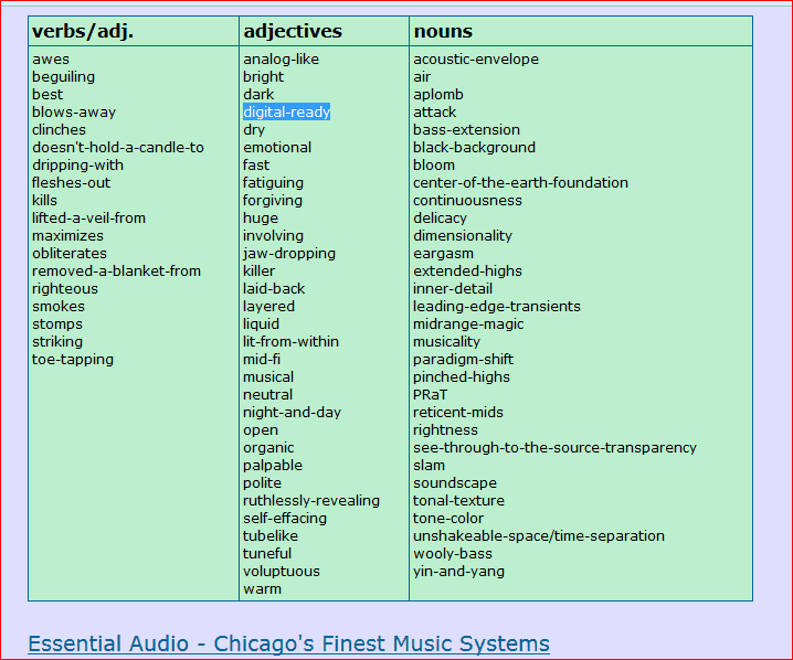

This is a funny page... check out their cliche generator -
http://www.essentialaudio.com/humor/cliche.htm
