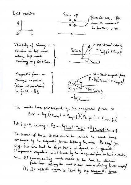

One gains a lot of insight by going back to first principles and looking at the origin of the back-emf in terms of forces.
For simplicity let the charge carriers in the wire be positive. It's easy to modify what follows for negative carriers if you wish. The conclusion will be unaffected.
Let the wires run in the ±x direction, and the current in the lower wire in the -x direction and the current in the top wire in the +x direction. So if the top wire were stationary, the drift velocity of carriers in it would be \mathbf{v}_{drift}\ =\ v_{drift} \mathbf{i}. But suppose the top wire is moving upwards (in the +y direction) with velocity \mathbf{v}_{wire}\ =\ v_{drift} \mathbf{j}. Thus the resultant velocity of charge carriers in the top wire, in the laboratory frame of reference will be \mathbf{v}_{drift}\ +\ \mathbf{v}_{wire} \ = \ v_{drift} \mathbf{i}\ +\ v_{wire} \mathbf{j}.
The bottom wire will be producing magnetic flux density in the –z direction, in the vicinity of the top wire. So the top wire is sitting in a field \mathbf{B} \ = -B \mathbf {k}.
So the force on a charge carrier in the top wire will be
q (\mathbf{v}_{drift}\ +\ \mathbf{v}_{wire})\ \times \mathbf{B} = (v_{drift} \mathbf{i}\ +\ v_{wire} \mathbf{j}) \times B (\mathbf{-k}) = q B( v_{drift} \mathbf{j}\ +\ v_{wire} \mathbf{(-i)}).
The second term represents a force on the carrier opposing its motion along the wire. Note that this term is zero when the wire is held stationary! For the wire to move upwards, and the current in it to stay the same, this force has to be opposed by a force from the electric field pushing the carriers through the wire. It is this electric field force which does the work lifting the top wire. The magnetic field acts rather as a pulley does on a rope, altering the direction of the force exerted.
'The second term represents a force on the carrier opposing its motion. Note that this term is zero when the wire is held stationary' this statement is confusing me. I don't understand fully what you are main point is in that math.
The main point in the maths is to show that when the wire moves (in the magnetic field from the bottom wire) there is a magnetic force on the charge carriers in the top wire, in the opposite direction to their motion through the top wire. It is work done against this force by the electric field on the charge carriers in the top wire, that supplies the work done to lift the top wire. The magnetic force acts a bit like an anchored pulley, not doing work itself, but changing directions of forces.
If the wire is stationary, so the second term in the final expression is zero, there will be no force parallel to the wire on the charge carriers, so no back-emf, which accords with Faraday's law: if no flux cutting, then no back-emf.
That's the best I can do, at the moment.

Yes. There are now two emfs acting in the top wire's circuit: that from its battery, opposed by the induced back-emf due to the flux cutting. The only way to maintain the original current (i.e. the current when the wire was stationary) is to increase the battery's emf (add more cells?).
""If the wire is stationary, so the second term in the final expression is zero, there will be no force parallel to the wire on the charge carriers''
This part is problematic as if the wire is stationary it does not mean that electrons are not flowing in it so the should feel the force. But is it that the force experienced by the electrons is equal to the force experienced by the protons in the wire?
'there is a magnetic force on the charge carriers in the top wire, in the opposite direction to their motion through the top wire.'

The electrons are indeed flowing, and this constitutes an electric current. Therefore they experience a 'magnetic force', a force due to their being in a magnetic field (due to the bottom wire. But, when the top wire is stationary, this force is in a vertical direction; there is no force component along the wire. Only when the wire moves vertically (and work is done by the magnetic force on the wire) is there a magnetic force component along the wire on the charge carriers.
No. The protons are stationary and so don't experience magnetic forces.
Abid Mir said:
Isnt the motion created by the magnetic field of the the below wire.how then the charge carriers feel a new magnetic force in the opposite direction of motion and where from.
That's what my analysis in post 12 showed. Did you follow it? If not, I think you'd be well advised to heed the wise and kindly words of BvU in post 17.
