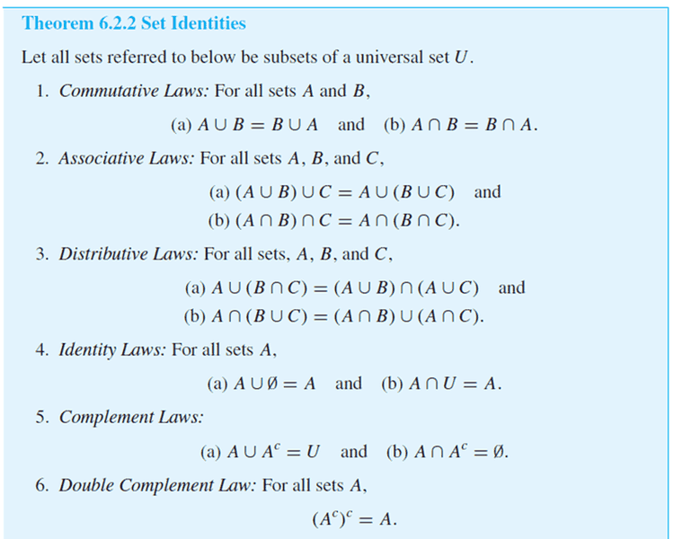

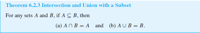

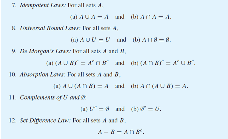

I have to use these set identities:
Pretty sure this is impossible because there's no identity for the Cartesian product.
Just go at it the old fashion way.
Suppose (a, d) [itex]\in[/itex] A X (B [itex]\cup[/itex] C). Then a [itex]\in[/itex] A. Also d [itex]\in[/itex] B or d [itex]\in[/itex] C. So (a,d) [itex]\in[/itex] (A X B) or (a,d) [itex]\in[/itex] (A X C).
Thus (a,d) [itex]\in[/itex] (A X B) [itex]\cup[/itex] (A X C).
Therefore A X (B [itex]\cup[/itex] C) [itex]\subseteq[/itex] (A X B) [itex]\cup[/itex] (A X C).
Proving the subset goes the other way follows similarly.
