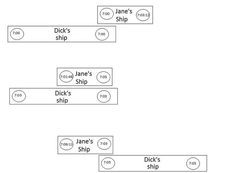

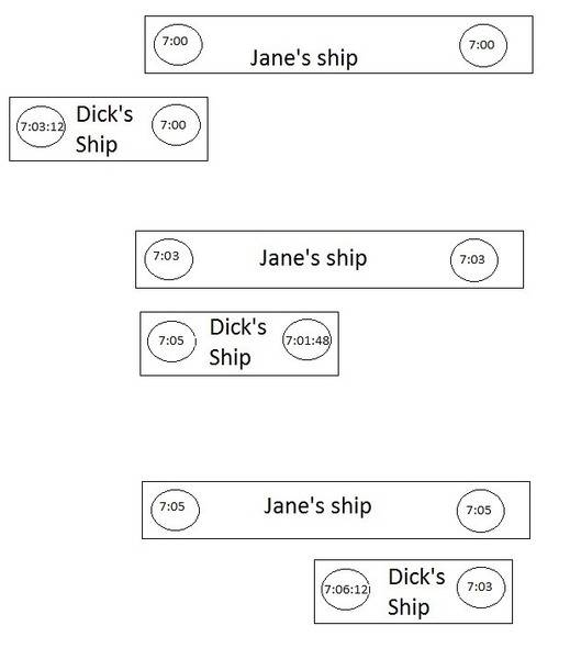

Here, I'm not talking about the twin paradox in which one of the observer's frame gets accelerated. I'm talking about the case in which they just move relative to each other without accelerating. I'm having some confusion. Please tell me where I'm wrong:
1.There are two people, Dick and Jane on Earth. Dick goes on space travel on a spacecraft which moves with a velocity 0.8c relative to Earth.
2. He leaves when both their clocks read 07:00 AM, and Dick takes one clock along with him. Both of them have telescopes by which they can observe the time elapsed on another clock. When the time is 07:05 AM on Dick's clock, he views Jane's clock from his telescope and sees that it is reading 07:03 AM.
3. So, when Jane's clock reads 07:03 AM, Dick's clock reads 07:05 AM.
4. So, if Jane views Dick's clock from her telescope when her clock reads 07:03 AM, she should see 07:05 AM on Dick's telescope.
5. But Dick is also moving at 0.8c for Jane, so by applying time dilation formula, so when Jane's clock reads 07:03 AM, i.e. 3 minutes have passed on her clock, only 1.8 minutes should pass on Dick's clock, so she should see 07:1.8 AM on Dick's clock.
6. So, when Jane's clock reads 07:03 AM, Dick's clock reads 07:1.8 AM. But this contradicts my third point.
Please explain this to me. Thanks.
The main missing factor here is that the definition of "at the same time" (that is, simultaneity) depends on the velocity of the observer, so events which are the same time according to one observer may be at different times according to another observer.
Also, any observation using a telescope or similar has to be adjusted for the light speed delay according to the reference frame of the observer.
A way of visualising this is to imagine two people walking in different directions. Each observes that the other one is going slower than themselves in their own direction, but there is no contradiction in this.

"At the same time" is an ambiguous statement, as others have mentioned. You need to distinguish between "at the same time according to Dick" and "at the same time according to Jane". You also need to distinguish "what Dick sees" from "at the same time according to Dick". So there are four different concepts here which you are confusing and combining:
1) What Dick sees on Jane's clock through a telescope/
2) "At the same time" according to Dick, which is what Dick sees with the propagation delays compensated for.
3) What Jane sees on Dick's clock.
4) "At the same time" according to Jane.
It's hard to reword your example because I'm not sure what you meant due to the ambiguity of your language. So if you'd care to re-write it unambiguiously, we can give you a definite answer for all four observations.

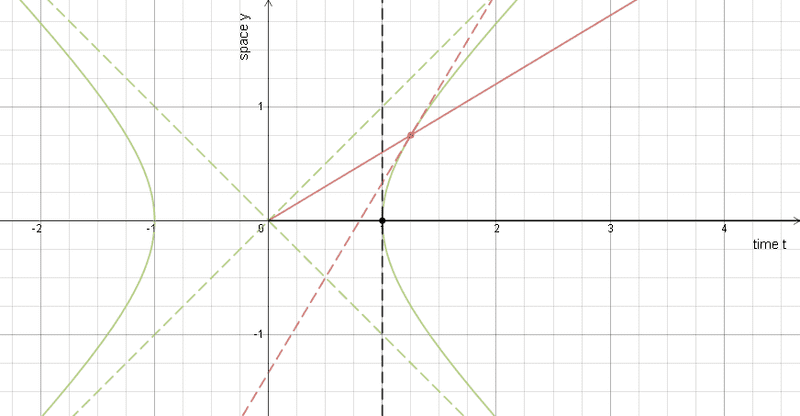

A spacetime diagram may be helpful here.
https://www.desmos.com/calculator/ti58l2sair [my t axis is horizontal ]
Tune v1 and v2 and you can see that their senses of simultaneity disagree in general... and that the time dilation is symmetrical in the sense that each observer's dashed line of simultaneity cuts off the other observer's 4-velocity (unit vector) by the same fraction. [Slide E to -1 to see the Euclidean version, and 0 for the Galilean version.]
