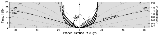

DrClaude said:
We can only see what used to be some 13 billion ly away from us,
Ah, but we can't (yet). Of all the light currently observed, the farthest distance at emission was approx. 5 Gly, if I'm eyeballing the following graph correctly:
Yup, i was being pretty dense.. But i totally get it now! Thank you!
I wrote "some 13 GLy" to give me some wiggle room, but I was far off the mark. Thanks for the clarification!
Correct. Here is a better resolution with the latest data. The past light-cone (Dthen) max distance is about 5.8 Gly, at time 4.2 Gy, which one can read off most accurately form the tabular output of the calculator.
