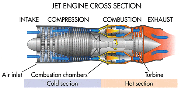

How can the jet engine power the generators? The jet engine is pure flame and after burner.. how does it power the generator? what kind of connection does it use?
I don't know the exact connections, but I assume the shaft running down the middle of the engine is connected to a gearbox which is then connected to the generator. So the shaft turns, turning the generator, producing electricity. The F107 jet engine in the missiles I used to perform maintenance on works in this manner:
Accessories. The accessory drive gearbox is driven by the compressor shaft. Gearbox outputs drive the airframe and engine ignition generators, lube pump, and fuel control. Hydromechanical fuel control is provided to control engine speed and acceleration/deceleration, along with a positive fuel shutoff. The self-contained lube system contains 1.3 pints (0.61 liters) in a reservoir.
Also, this isn't true. The entire engine prior to the combustion chamber is relatively cool since it is pulling in ambient air. The compression of the incoming air increases its temperature somewhat, but nowhere close to the temperature of the combustion chamber and other parts "downwind" of this. See the following picture:
A jet engine has a compressor and turbine on a shaft -- the shaft also turns a generator.
