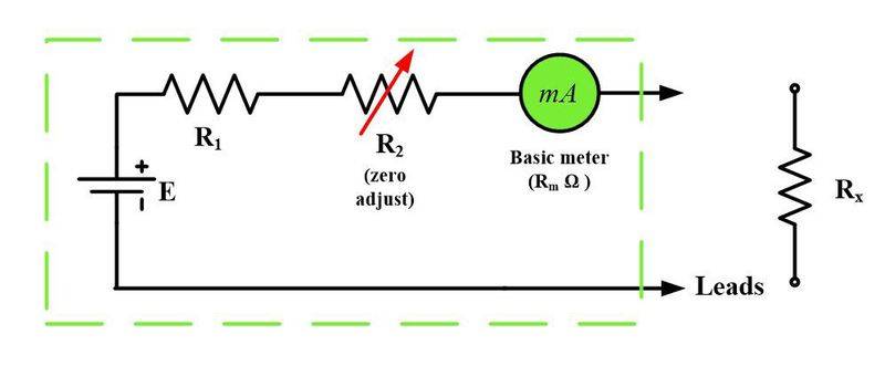

It is nice to understand what's inside your test equipment. That way you don't blow it up nearly so often.
Basic analog ohm meter is a galvanometer.
E1 is typically a 1.5 volt AA cell.
R2 adjusts for run down battery.
R1 is the reference resistor to which unknown Rx is compared..
Non linear meter scale calculates ratio of Rx to R1, shows Rx .
http://electricalacademia.com/instr...ts-and-working-principle-ohmmeter-definition/
R1 will be the value written at the center of the analog scale. Can you figure out why ?

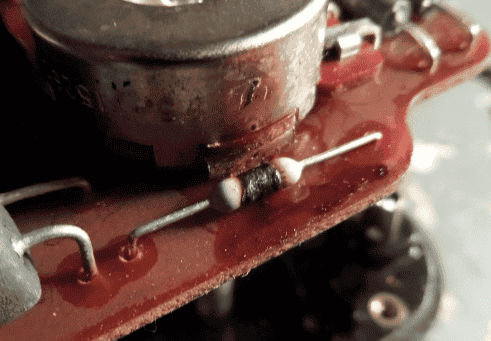

An analog one is vulnerable on low ohms scales. Here's why:
For simplicity assume
R2 is set to zero.
E1 is a 1.5 volt AA cell
R1 is ten ohms
meter is ideal, its R is zero
so when Rx is zero,
current is 150 milliamps and that gives full scale meter deflection.
Power in R1 is I2R = 0.152 X 10 = 0.225 Watts, not quite ¼ Watt
If Rx becomes ten ohms then current is 1.5volts / 20 ohms = 75 milliamps, half as much as before giving half scale deflection.
Power in both R1 and Rx is now 0.0752 X 10 = 0.056 Watt, not quite 1/16 of a Watt apiece.
If Rx becomes instead of resistance a source of +12 volts
then current becomes (12-1.5)volts /10ohms = 1.05 amps, a 7X overload for the meter
and power in R1 becomes 1.052 X 10 = 10.5 watts . It's probably a 1/4 Wat resistor, soooo...
That's why you see so many analog meters with the low ohms resistor burnt up.
