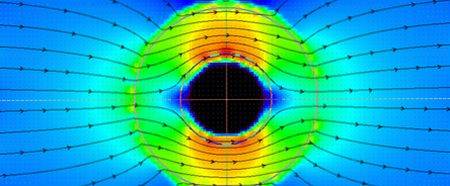

Here is an image of the B-field lines of a flat field being attracted to a ferrous sphere -- the simulation shows the shielding effect excluding the field from the inner hollow part of the sphere.
http://www.magneticshields.co.uk/images/magnetic-field-flow.jpg

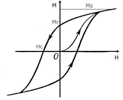

Not necessarily. It depends on the material. The wider the hysteresis curve for the material, the more residual magnetization you will have. But some materials have pretty skinny hysteresis curves...
http://www.intechopen.com/source/html/48734/media/image28.jpeg
image28.jpe
AFAIK, the hysteresis curve is caused by the (un)willingness of the magnetic domains in the ferrous material to align, and/or re-align later, as is dictated by the particulars of the physical structure at the atomic level, but once they align, it is essentially a proper magnet from that point onward.
