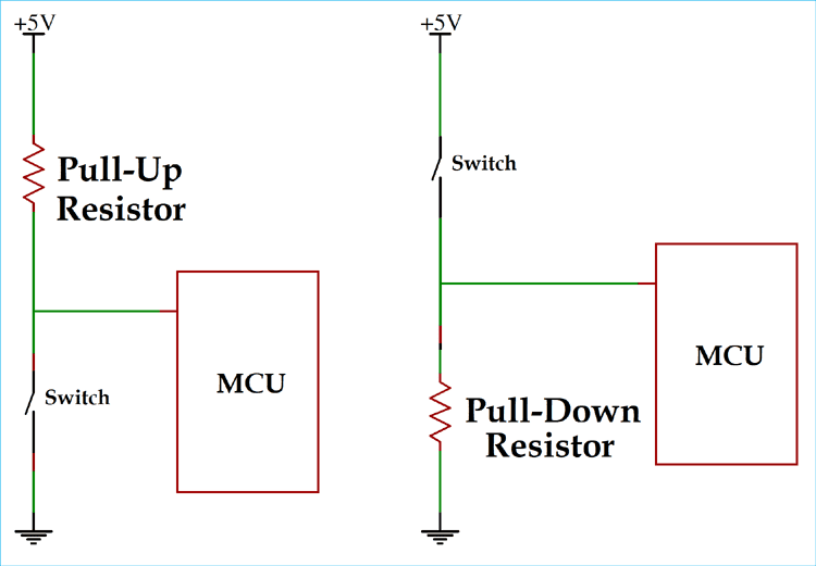

I’m doing a project with my Arduino, and I’ve seen some tutorials on YouTube explaining how to use pull up or pull down resistors to make the input values on the board reliable, basically either a 0 or a 1 without any random changes from other em sources.
The only thing is I still don’t understand why it works. The videos explain how to create the circuit but not so much the theory behind it.
Any help is appreciated.

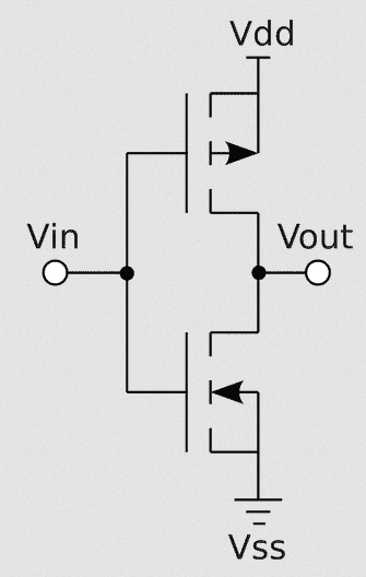

The old TTL technology may not have needed default pullup/pulldown resistors, but CMOS logic certainly does. There are two fundamental issues -- First, the CMOS inputs are very high impedance, so if they are left open, they can float high or low depending on static charge or even loosely coupled EM fields like AC Mains noise on nearby conductors. I once made a neat little LED 8-bit monitor circuit that could probe 8 logic signals and show me their state on the LEDs. I learned quickly that any unconnected inputs could show high or low based on my hand coming close to those inputs (static charge and AC Mains noise). Lesson learned.
Second, if CMOS inputs are floating near their mid-input voltage (say around 2.5V for a 5V CMOS input), the whole logic gate circuit can go into the linear region for the transistors, and conduct significant current from the power rail to ground. Typically it won't be enough current to hurt the logic, but it will put you well above your Icc budget for the circuit.
https://upload.wikimedia.org/wikipe...MOS_inverter.svg/1200px-CMOS_inverter.svg.png

Stop thinking about noise, it's nothing to do with noise.
Look at your first circuit: when the switch is open a very small current flows from the +5V rail via the pull-up resistor to the input pin, which signals HI. When the switch is closed a very small current flows from the input pin via the switch to ground and so the input pin signals LO.
If the pull-up wasn't there and the switch was open then the input pin still has to signal either HI or LO, but who can tell which it is going to be? If there is a leakage current to ground then maybe it will be LO, or maybe there is some square wave clock signal PCB trace passing close which induces a current in and out of the pin which oscillates from HI to LO (OK, noise may be something to do with it) - the point is that if you leave it floating you have no guarantee whether it will be HI or LO.

Another way to look at it: take away the resistors from both of the circuits in your OP so all that's left is the switches and the MCUs. When the switches are closed, the first input reads LO and the second input reads HI. When you open the switches, the circuits in the two diagrams are electrically identical; how does the one on the left know that you want it to read HI and the one on the right LO?

They are not a filter. Please un-learn that concept.
The resistors provide a medium-impedance tie to one of the rails, ensuring that the input voltage is well defined. The input impedance of CMOS logic inputs is in the MegOhms, so attaching a 10kOhm pullup/pulldown resistor easily defines the input voltage.
You just need to ensure that whatever your external drive circuit is can overpower the pullup/pulldown resistor to assert the other logic level. You would not use a 10 Ohm pullup resistor, for example, because it would be very hard for a connected logic output to fight that pullup and pull the input pin below Vil to cause a logic low input.

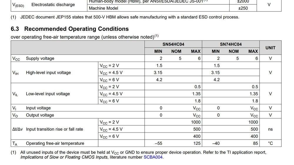

Does that make sense? Can you link a couple of CMOS logic gate datasheets that you've been reading to learn about input Vil and Vih specs and Vol and Voh specs? Thanks.

It simply means a connection. In the first circuit it ties the pin to 5V (or 'pulls the pin up') and in the second it ties the pin to ground (or 'pulls the pin down').
In your first circuit with the switch closed there is a connection to ground, so the pin reads 0. Open the switch and there is a connection via the resistor to 5V (the current the pin draws is tiny so we can ignore the voltage drop across the resistor) so the pin reads 1. In your second circuit with the switch closed there is a connection to 5V, so the pin reads 1. Open the switch and there is a connection via the resistor to ground so the pin reads 0.
Now take away the resistors.
In your first circuit with the switch closed there is a connection to ground, so the pin reads 0. Open the switch and there is no connection to anything so the pin is 'left floating' and doesn't know what to read. In your second circuit with the switch closed there is a connection to 5V, so the pin reads 1. Open the switch and there is no connection to anything so the pin is in exactly the same condition as in the first circuit: it is 'left floating' and doesn't know what to read.

Basically it's like this. Imagine that instead of your MCU, it was a voltmeter that was connected between your MCU pin and ground (basically for all intents and purposes, is how a logic input would operate), and on the other side of the voltmeter is another circuit (which would be the rest of the internal MCU circuitry).
Now let's say you designed your program to recognize the switch's CLOSE position with a logic of 0 (in which case, our voltmeter should read 0V). When you let go of the switch (I'll assume this is a simple switch, and not a detented/holding type), how do we make sure that our voltmeter reading registers +5V (switch's OPEN position) at the moment of open circuit, without being affected by the goings on in the other circuit (internal MCU circuitry)?
The reliable answer would be by connecting a pull-up resistor from pin to +5V, in order to ensure that our voltmeter reading is as close to +5V as possible, as soon as possible, as reliably as possible, and force the MCU to acknowledge ASAP that we have opened the switch, and for good. Pull-up resistor value should be significantly large, as we are not trying to pass current, and should therefore minimize voltage drop.
Same narrative with the pull-down resistor for forcing MCU to acknowledge logic 0 (voltmeter reading of 0V) if you want it to recognize logic 0 = switch OPEN.
