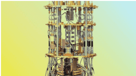

So I have heard that IBM and Google have constructed Quantum computers, how does one actually construct a Quantum computer? I would like as much detail as possible on the construction of one of these devices and how it works exactly, I wanted to buy a Spin Q Quantum computer and I understand how binary computers work however not so much for Quantum computers could you guys give a insight into the process of making one?
This article may help you understand.
https://www.technologyreview.com/2020/02/26/916744/quantum-computer-race-ibm-google/
I hope your budget is as big as IBM's. Just kidding. Seriously, it is still on the leading edge of technology that only a few researchers can achieve. It is far from the reach of DIY.

There are many ways to build a quantum computer. There are platforms built around superconducting qubits, spin qubits, ion traps and photonics; just to mentioned a few.
One thing they all have in common is that they require a LOT of expensive kit to operate. The actual "heart" of the computers is not actually that complicated for some of these implementation (say superconducting or spin based ones) and if they were mass produced (which they are not, you can't buy one) they would probably not be very expensive. However, the computers require a LOT of microwave equipment ( for superconducting and spin based platforms) or lasers (ion traps or photonics) since all signals in and out are in the microwave range (typically 4-8 GHz). Moreover, all platforms with the exception for ion traps also need to be cooled down to very low temperatures; the type used by IBM and Google are cooled below 20 mK.
Currently, the equipment you need for a "basic" quantum computer with a handful of qubits will cost you about $1-2M . You then also need a lot of custom HW and a LOT of software to get it to actually do anything.
It is quite unlikely that we will ever get to the point where you can buy a stand-alone quantum computer and put it on your desk; even if the technology somehow develops to the point where it would be possible there simply wouldn't be much point; cloud access to a HPC system which includes a quantum processors is likely to make much more sense.
It is the same reason why very few people currently have a TPU of a FPGA accelerator card on their desk; they make much more sense when integrated with a HPC system
(yes, I am aware that there are already companies making very simply processors that do (nearly) fit on a desk; but they are meant for demonstrations and teaching; they are not full-scale processors; and you still need to supporting electronics and SW
