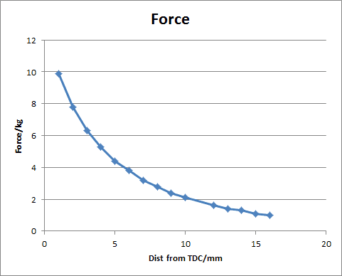

1. How do you calculate the average force on a piston in one stroke from TDC to BDC given the following Kg forces and their distances in mm from TDC?
1 mm 2 mm 3 mm 4 mm 5 mm 6 mm 7 mm 8 mm 9 mm 10 mm 12 mm 13 mm
9.9 Kg 7.8 Kg 6.3 Kg 5.3 Kg 4.4 Kg 3.8 Kg 3.2 Kg 2.8 Kg 2.4 Kg 2.1 Kg 1.6 Kg 1.4 Kg14 mm 15 mm 16 mm
1.3 Kg 1.1 Kg 1 Kg
2. I am absolutely blank.3. Tried a sample average, but as the sample increases so the average drops.

TDC is at 0, but what is the stroke length ?
You could let excel fit a polynomial and integrate, but you still need the BDC position.

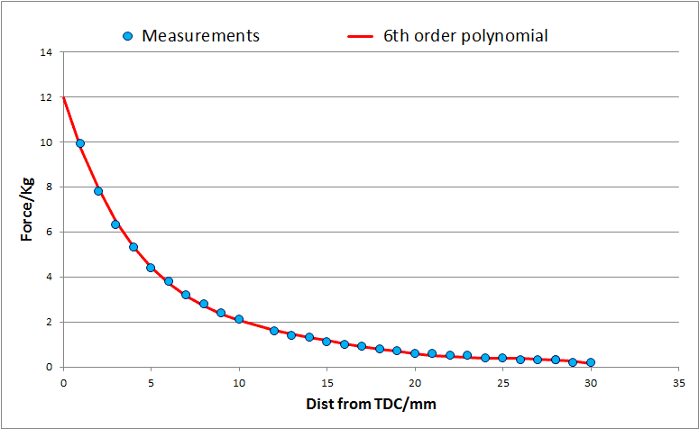

I had fun going through this:
A 6th order (bit much..) polynomial (the red line) gave
y = -0.00000408x5 + 0.00038121x4 - 0.01390910x3 + 0.25371572x2 - 2.47577020x + 11.96556136
Integrating from 0 to 31 gives the area under the red curve
A = -0.00000408x6/6 + 0.00038121x5/5 - 0.01390910x4/4 + 0.25371572x3/3 - 2.47577020x2/2 + 11.96556136x with x = 31 that gives an average of 68.7/31 = 2.22 (if I didn't make any typos...)
A simple average gives 2.05
If you add an extra measurement at TDC of 12 kg, then a direct average gives 2.29.
However, this gives too much weight to that TDC point (it is an estimate for 0-0.5 mm, the measured 10 kg is for 0.5 to 1.5 mm) so a better estimate is to give that point half the weight of the others:
(sum of measurements + 12/2)/30.5 = (61.4+6)/30.5 = 2.21
(close to the integral value)
