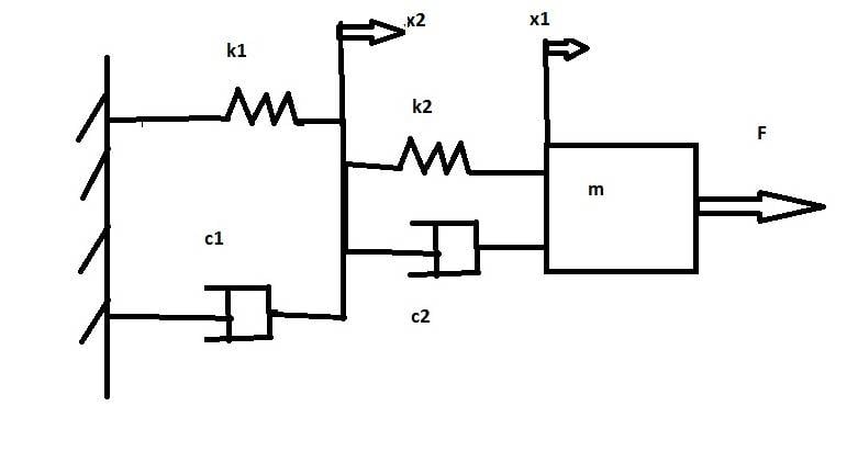

Mechanical schematic of a two-degree-of-freedom spring-damper system: a wall on the left connected by spring k1 and damper c1 to a node labelled x2, which links through spring k2 and damper c2 to mass m, with force F applied to the right and displacement x1 marked.
I assume that F is the input to the system, and that you will have to find x1, x2 ( velocities? ) as a function of F.
If you are confident with Laplace transforms, I'd build a model by means of Laplace function blocks.
After I gotten this equation, I tryed to excrete x1, but I'm missing one equation to make a state space model.
I think I need to get matrix A 4x4 and I don't know how to get x2 double derivate when it doesn't exist, if you know what I mean.

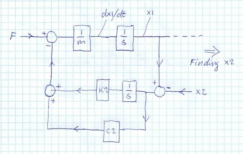

No, this is not made by function blocks, here is what I mean:
Hand-drawn block diagram on grid paper of a feedback loop: input F summed into 1/m, then 1/s giving dx1/dt and x1; a lower path with K2 and 1/s, and a C2 block, feeding back into summing junctions; an arrow labelled Finding x2 points to x2 at the right.
You draw these blocks/loops and reduce them afterwards. For example the 4 blocks in lower left corner can be reduced to one block:
k2/s+c2
The loops can be reduced by Masons rule.
At last you will have the transfer functions: x1(s)/F(s) and x2(s)/F(s). For example you put on some step function: F(s) = 1/s, and you will find x1(s) and x2(s).
Alright, I know what you mean, but how will I draw a loop to apply mason rule, I get confused when I need to put x2
Say you have a closed loop (negative feed back).
Say that the forward path has the transfer function: A(s) and that the backward path has the transfer function: B(s), then Masons rule says that the transfer function for the loop as a whole =
A(s) / ( 1 + A(s)*B(s) ) . . . . ( It's easy to prove ).
If the feedback is positive, you simply change the "+" to a "-".

Questions:
* What is x2? Input or output (according to your block diagram)?
* Where is c1 in the diagram?
x2 is the velocity(?)/position(?) in the diagram shown in #2. This diagram is just a copy from one of the links in #1. I don't know, I have assumed it's an output, and that F is the input.
c1 ( and k1 ) is coming up when the diagram is expanded in #8 to the right: ( "Finding x2" reference ).
The diagram in #8 has just not been finished ( something left for ja5 to do ).
OK - so I wait until it will be finished. The procedure of block diagram reduction is a standard one and shouldn`t be a problem.

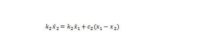

Equation: k2 x-dot 2 = k2 x-dot 1 + c2 (x1 - x2), with x-dot denoting time derivatives of x1 and x2.
This is not right. By Laplace it could be written: k2*s*x2 = k2*s*x1 + c2(x1-x2) , and that's a 1. order system. A spring and a mass will oscillate which means that the system must be a 2. order system. You may not assume a mass (A), when it is not there.
In the (half) model in #8, you must complete the model. Then you can see what you are doing. Complete it and reduce it.
In #8 a force, F, is induced. Dividing this force by m you will get the acceleration of m: ( dx1/dt ). If you integrate this acceleration ( divide by s ) you will get x1.
The back-force ( as to F ) will be induced by:
1) by c2: Fback = x1*c2.
2) by spring: Fback = (x1/s)*k2 : Dividing x1 by s, you integrate velocity to position, thus Fback = Δposition * k2.
But in (2) the velocity is missing: Correctly it must be: Fback = ( (x1-x2)/s ) * k2.
The Fback is subtracted from F ( left sum block ) so that the resulting force, pushing m, is: F - Fback. ( Loop closed ).
ja5 said:
Can you draw me whole loop?
Something like this:
ja5 said:
but what is F2?
It's the force at x2.
