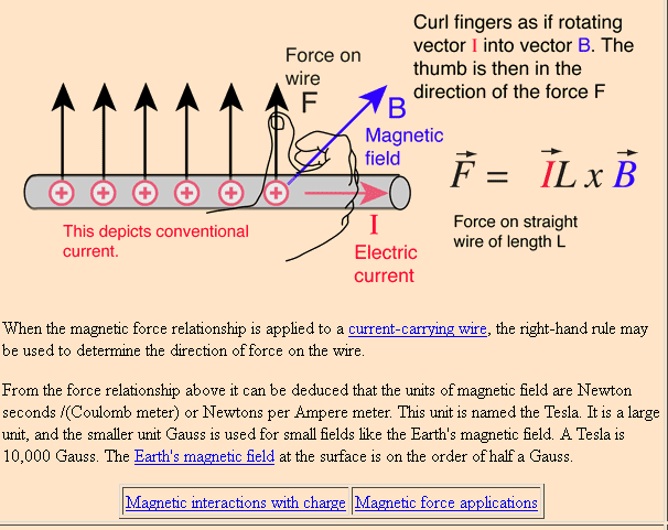

Do you know about the force exerted on a charge that's moving in a magnetic field ? Does "Right Hand Rule " ring a bell of familiarity ?
from http://hyperphysics.phy-astr.gsu.edu/hbase/magnetic/magfor.html
Imagine that wire is in the armature of a motor. Current through it causes it to experience a force that turns the rotor. Work is done when the wire is pushed by that force through a distance.
Since motor rotors tend to be cylinders with loops of wire, the force becomes a torque that's transmitted to the shaft

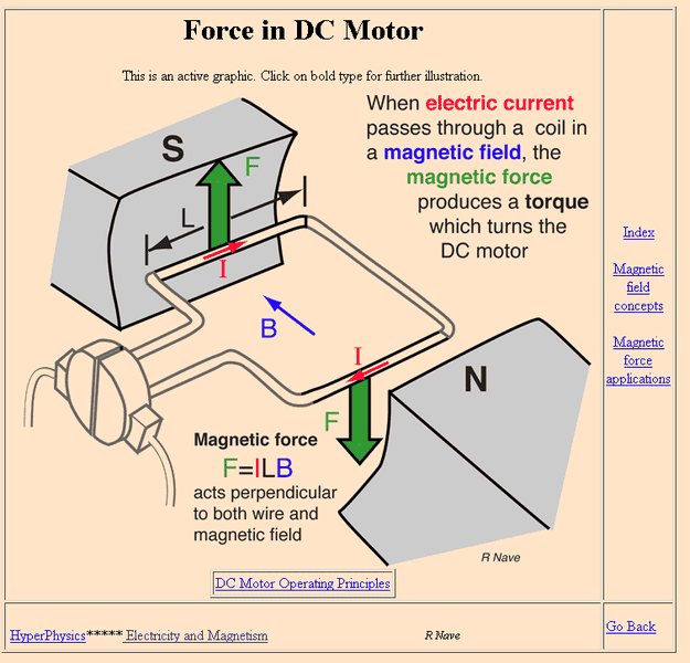

Look up torque on a coil that's carrying current in a magnetic field.
from http://hyperphysics.phy-astr.gsu.edu/hbase/magnetic/motdc.html#c5
Power is torque X RPM X a constant that accounts for units.
