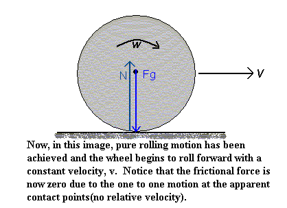

If the cylinder is rolling along a horizontal plane without accelerating, then there's no static friction at all (ignore rolling friction and other complications). Also, with respect to the surface, assuming rolling without friction, the contact point of the cylinder always has zero speed.

"Also, it's confusing because physics books say that friction always opposites movement. But if the cylinder is rolling on a plane, say, right, then the rotating movement would be clockwise. Why isn't the friction then opposing that rotating movement so that the friction force would be pointing right also? I mean, the lowest point of the cylinder is always moving left."
Consider these:
  • Diagram of a wheel rolling on a surface with angular velocity w, velocity v to the right, normal force N and gravity Fg acting through the centre, and text stating frictional force is zero during pure rolling.

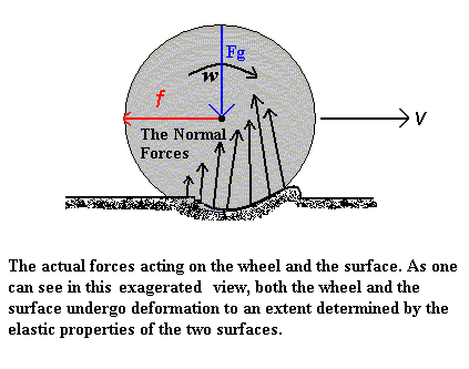

  • Diagram of a wheel on a deformable surface showing upward normal force arrows across the contact patch, with labels Fg, f, w and V and the caption about exaggerated deformation.
edziura's second attachment illustrates "rolling" friction. I suggest that you ignore such complications until after you've nailed down the direction of static friction.

About that answer for the second problem, if we continue with common experience. What will make the cylinder stop in the real world if the friction is the force that makes it move in the same direction? Is it the rolling friction in that case?
