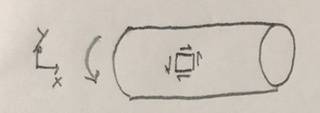

I am trying to determine the flow of mechanical power through a structure like a drive shaft or even a simple lever. The components of the Cauchy stress tensor, ##\sigma_{ij}##, have units of force/area, so if I multiply by the velocity, then ##\sigma_{ij} v_j## would have units of power/area. And since it is a vector I would interpret it as the mechanical power density crossing a surface normal to the vector.
Is this correct? If anyone has taken some mechanical engineering courses that discussed this quantity or another quantity which can describe the flow of mechanical power within a structure, I would greatly appreciate any insight.

I think that I may have had the sign convention backwards above. I worked out two examples.
If you are pulling a rope in the -x direction then power flows in the +x direction.
The only nonzero component of the stress tensor is ##\sigma_{xx}## and the only nonzero component of the velocity is ##-v_x## so ##-\mathbf{\sigma} \cdot \mathbf v## gives power flow in the +x direction.
Similarly, if you are turning a shaft in the direction shown then power flows in the +x direction
The only nonzero components of the stress tensor are ##\tau_{xy}=\tau_{yx}## and the only nonzero component of the velocity is ##-v_y## so again ##-\mathbf{\sigma} \cdot \mathbf v## gives power flow in the +x direction.

Dale, if the contraction you described between the stress tensor and the velocity vector is then contracted subsequently with a unit normal vector to a surface (either internal or external), the quantity obtained is the rate of doing work per unit area of the surface. This quantity is included in the differential energy balance on. parcels of material within the body or the fluid.
OK, that sounds like it is what I wanted, although I didn’t think of that subsequent contraction. Do you have a reference for this that I could read more from.
It seemed to work for a rope and for a driveshaft, but at first glance it looks like it will not work for a lever since the power flux should go to zero at the fulcrum where v goes to zero. I have not yet worked it out to be sure, so hopefully I am wrong.
I don’t know much about your power flux interpretation, but the use of the approach I described for the rate of doing work at a boundary can be found in all books on continuum mechanics. See also Transport Phenomena by Bird, Stewart, and Lightfoit.

I think it is approximately the same thing, although I don’t know the terminology. The rate of doing work is mechanical power, and I am interested in the mechanical power that crosses an arbitrary boundary inside a simple machine like a rope or a shaft or a lever. I think that if you take the vector field that I described as the power flux and then integrate it across an arbitrary boundary that you get the power at that boundary.
The idea is that if I am doing work at one end of such a device and the device is doing work at the other end then the energy should not just magically disappear at my end and appear at the other end, but there should be a clear path within the device where energy moves from place to place internally in a systematic fashion.

I worked this out and it seems like it works for a lever also. The key was that a real lever has thickness. This means that there is only one point with v=0.
For example, when the lever is horizontal the top surface has a large vertical velocity at the end which decreases linearly to 0 at the fulcrum. This is combined with a constant shear stress to produce a power flow in the horizontal direction which decreases linearly to zero at the center. However, the lever also has a small horizontal velocity which is constant across the surface. This combined with the linearly increasing longitudinal stress from the bending moment produces a linearly increasing power flow in the horizontal direction. These two flows together combine to make a constant power flow in the horizontal direction, even around the fulcrum.
